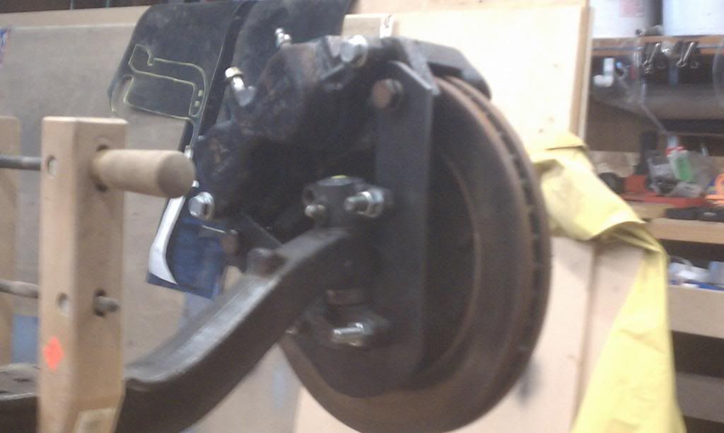

Looks workable to my UNTRAINED eye. Your 52 was Huck brakes? Are those disc components "Available Factory parts or your own home design? You got a Parts List? Thanks Bill

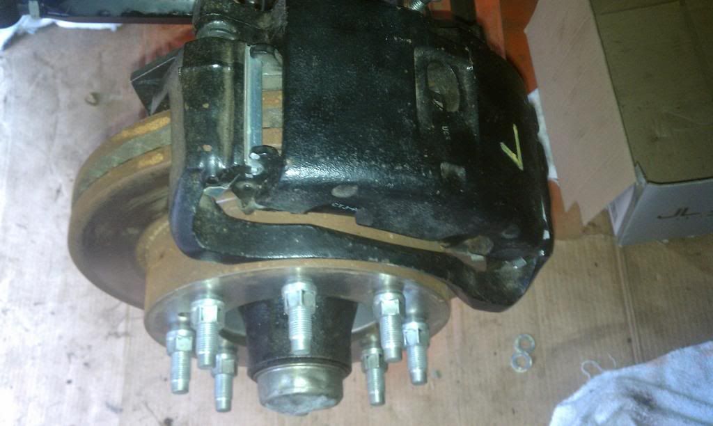

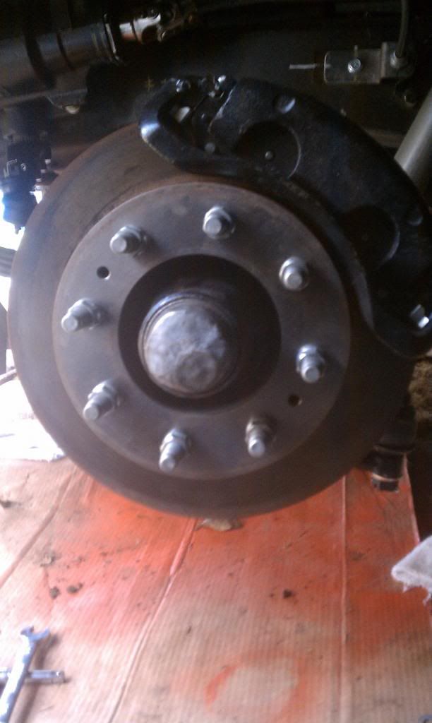

The rotor and caliper assembly are off of a 2007 Chevy one ton Express Van. 3/4 ton would likely work as well. I had an eight lug billet spacer machined to fit the hat of the rotor. Otherwise, it's a "one off" bracket that I designed and had a pair cut locally. Michael.

1 1/2" billet spacers are what I used. They work like a champ. And 3" extra width on that narrow front track can't hurt. You will have to run 17" wheels for everything to clear...

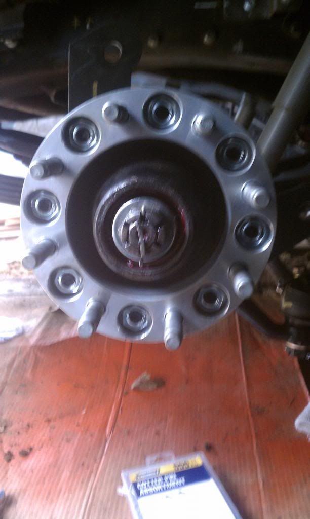

So you put the 1.50" spacer behind the Chevy Express rotor, how do you attached the spacer to the old Chevy hub?
With this spacer it enables you to have a one piece flat caliper bracket right? Looks like .25" steel plate...yes???

Hi. It's a common aftermarket billet spacer that is drilled to an 8 x 6.5 lug pattern and has lug bolts in the same pattern. Available virtually anywhere. Bolt it on your hub. Then bolt the rotor on to it. Yes, 1/4" mild steel plate.

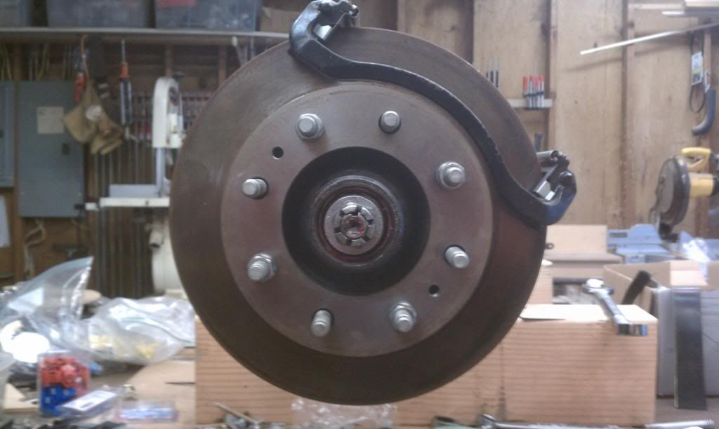

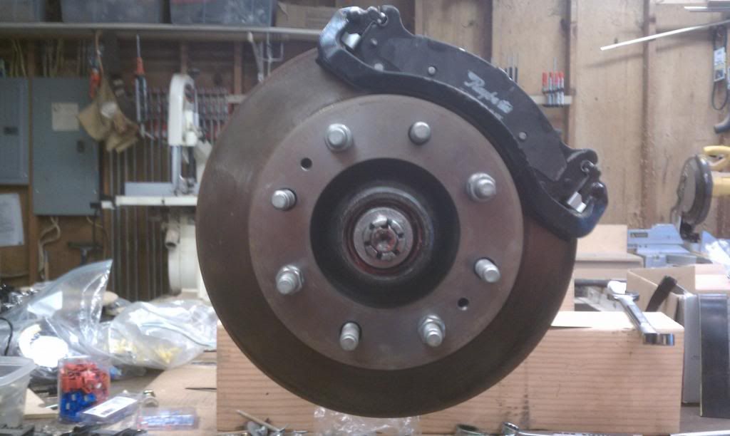

Just recently I found out that 96 f350's have a rotor that is not quite as deep. It's 3.1 thick vs, 3.5 for your rotor. So, it cuts about 3/8 off your total thickness of spacer. It's 13" round though, so 17" or larger wheels would definately be required for that caliper.
I'm planning on using a spacer too, but I'm using slightly smaller calipers. I think I'll end up with only about 3/4" of spacer at the most.

I've been using rear rotors from an 03 and newer van. They are slightly shallower, but again 13" round. I'm also using the van rear calipers. The setup fits in a 16" rim. I only have my plywood bracket right now to work with. I may try to get my hands a Ford rotor though.
I started off with the van front rotor and caliper, but I couldn't get it to mount like I wanted it. The 53-59 trucks have a taller spindle and kingpin, which created just enough clearance issues for me to abandon it.

Just an update. The Ford rotors I mentioned earlier are a no-go.
While they are the 8x6.5 bolt pattern, the hub won't fit inside them.
