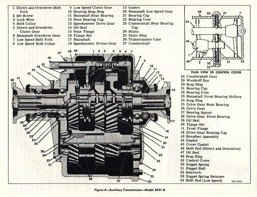

http://talk.classicparts.com/attachment.php?attachmentid=2375&d=1217837953
part #13 in the diagram
its a watson 46
