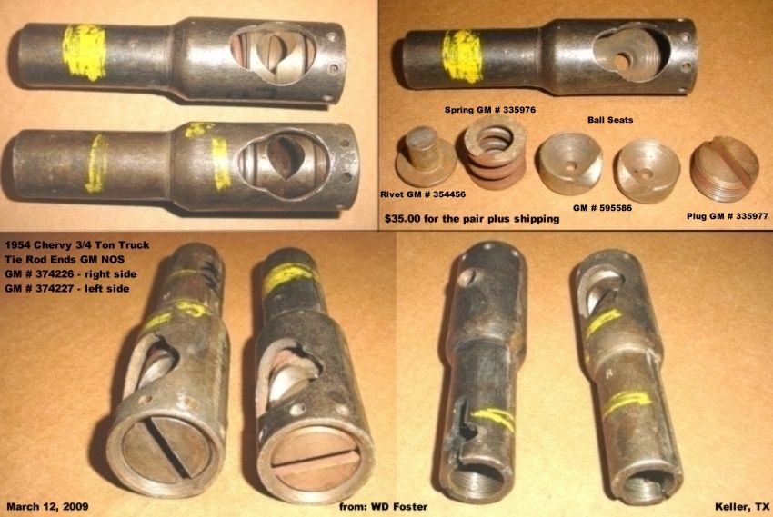

Purchased these tie rod ends complete
from WD Foster of Keller, Texas. It was quite
a nice deal !
http://i669.photobucket.com/albums/vv57/glp0329/Tie%20Rod%20Ends/WD_Foster__zps559ff4b8.jpg

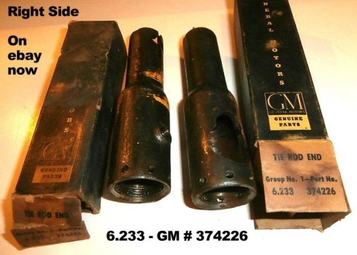

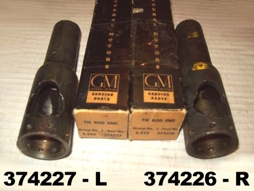

The tie rod end fittings are:
GM # 374226 - Right Side
GM # 374227 - Left Side
http://i669.photobucket.com/albums/...Rod_End_Fittings_GM_NOS__zps7c0a5e32.jpg
http://i669.photobucket.com/albums/vv57/glp0329/374227b_zps3a76c17f.jpg
http://i669.photobucket.com/albums/vv57/glp0329/374226_Tie_Rod_Fitting_NOS_2_zps3688117b.jpg

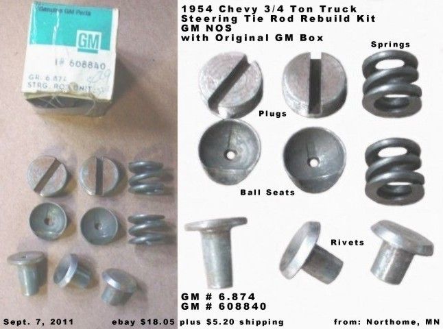

has ( 1 ) GM NOS # 608840 - Tie Rod End
internal parts rebuild kit.

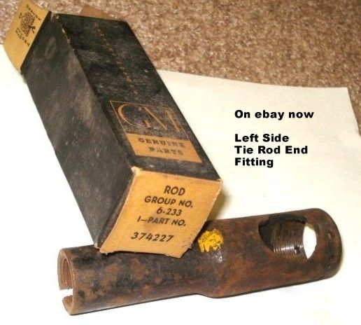

There are Tie Rod End fittings on ebay
now. Go to ebay & type in the part #
374226 & 374227. Several are up for sale.

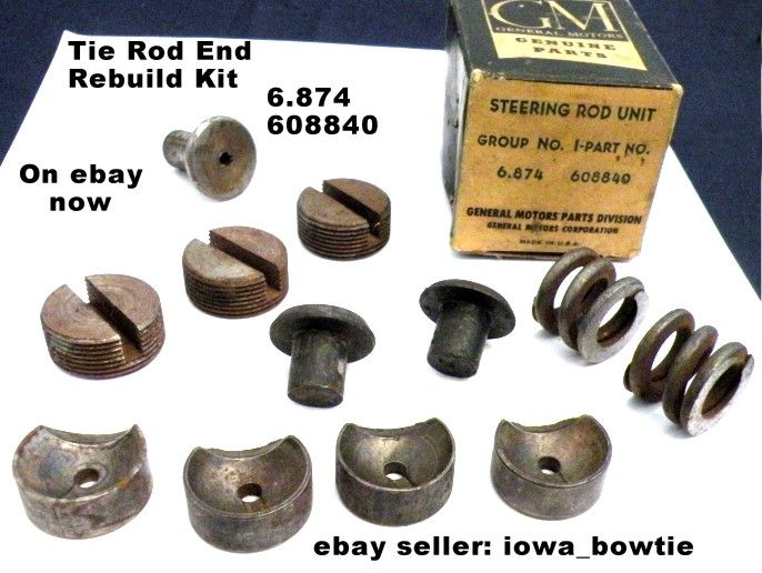

The Tie Rod end internal parts kits
are available aftermarket.
Many suppliers have them.
There is (1) GM NOS internal parts kit
on ebay now...GM # 608840
ebay - internal parts kit
$69.99 or make offer
http://i669.photobucket.com/albums/vv57/glp0329/Tie%20Rod%20Ends/Rebuild_Kit_zps36b81e36.jpg
Rebuild Kits that I purchased on ebay.
http://i669.photobucket.com/albums/vv57/glp0329/TieRodEndRebuildKitGM608840_zps44266582.jpg
http://i669.photobucket.com/albums/vv57/glp0329/SteeringRodUnitGMNOS608840_zpsbd89df89.jpg

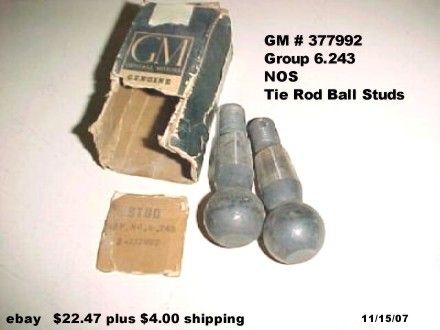

Friesens Chevrolet
Sutton, Neb.
Has ( 1 ) GM NOS Ball Stud - GM # 377992
phone #: 402-773-5538
Ball Studs that I purchased, below:
http://i669.photobucket.com/albums/vv57/glp0329/TieRodBallStuds_zps044aa31b.jpg
http://i669.photobucket.com/albums/vv57/glp0329/TieRodEndStudsGMNOS_zps361a8a50.jpg

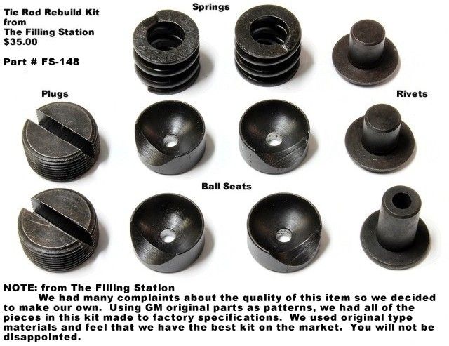

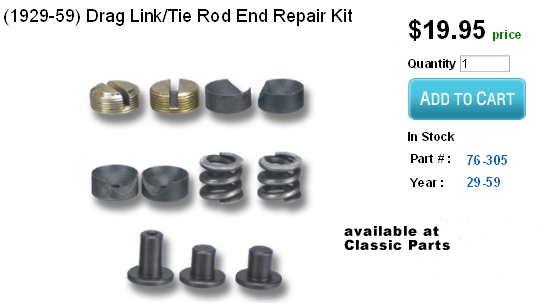

Tie Rod Internal parts kit - aftermarket
http://i669.photobucket.com/albums/...pair-Kit_productinfo_76-_zps13cef7bc.png
http://www.classicparts.com/1929-59-Drag-Link_Tie-Rod-End-Repair-Kit/productinfo/76%2D305/
The Filling Station has the internal parts kit.
BEWARE: Bad quality internal parts kits
are being sold by parts vendors.
This one seems good according to The Filling Station.
Read the note in the photo.
http://i669.photobucket.com/albums/...s/Filling_Station_FS-148_zpsf7201a60.jpg

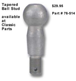

Ball Stud - aftermarket
http://i669.photobucket.com/albums/...GM%20NOS/TaperedBallStud_zpsdafcb9c2.jpg
http://www.classicparts.com/1947-59-Ball-Stud-Tie-Rod-3_4-Ton/productinfo/76%2D514/

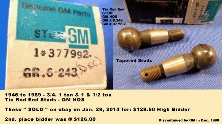

I just went to ebay to see if I could
find some Tie Rod End Studs GM # 377992
I checked the completed auctions using
the part # as the search factor.
I found these sold on ebay for what I
consider to be a really crazy price !
Photo @ photobucket:
http://i669.photobucket.com/albums/vv57/glp0329/Tie_Rod_Studs_sold_on_ebay__zpsf075a10e.jpg

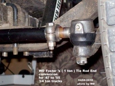

Crenwelge,
WD Foster emailed me this photo on
April 08, 2010, ( from my email archives folders ).
He had come up with a ( 1 ) ton
Tie Rod Conversion kit for 3/4 ton
trucks.
Here's the photo WD sent to me.
photo@photobucket
http://i669.photobucket.com/albums/...odconversionGMC150series_zpsef3ae41f.jpg
WD probably sent it to you to Crenwelge.
I too miss WD.

That's very interesting. I'm a little confused, are you saying
that was a stock tubular tie rod from a 1-ton and was being used
on a 3/4-ton?
That's exactly what I've been putting together for use on
my '54, 3600. He didn't post and numbers if those were stock
parts did he?

When I started buying front suspention
parts. WD suggested, that I upgrade to
one ton tie rod ends. He said, he had made
up a kit & it would run me about $150.00 .
I never learned anymore about his kit as
I was & still am a GM NOS parts only guy.

Looking at the 1929-57 parts manual the 1, 1 1/2TON tie rod was
hollow. The thread is really weird, 13/16-16 is not a standard
thread size. WD must have had a bunch of NOS tie rods and tie
rod ends in his inventory.
The tie rod I've made up for my '54, 3604 uses a pair of Moog
ES150 L&R ends and a 1 x.156" wall DOM tube. All of that is
readily available at a cost of about $75-$80. Putting the
3/4-16 L&R hand threads in the tube is the biggest problem for
the average back yard mechanic who wouldn't have the taps.
http://www.pbase.com/dennygraham/image/154464324
DG
