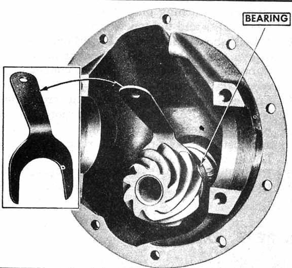

Pinion gear assembly
      Pay close attention to the order of the parts on the pinion shaft. The bearings are a no-brainer, (watch for the preload notch on the big bearing) but I was unclear on the purpose of the oil control washer and the bearing retainer ring flopping around on the pinion shaft. I almost put the bearing retainer on backwards even after reading Patrick's instructions closely. Just remember that the beveled shoulder on the retainer ring is where the three retaining lock ring bolts push on and preload the big double row front pinion bearing.

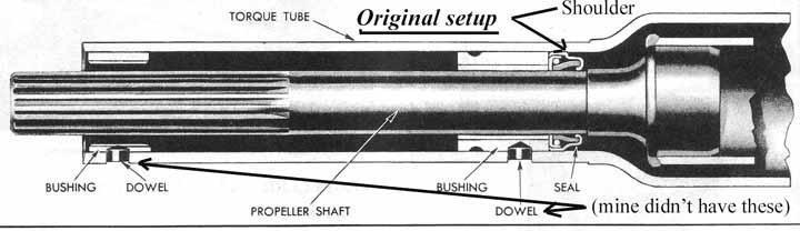

      About here, I should comment on the two bushings that are pressed into the front of the torque tube. They support the driveshaft and U-joint assembly. The back one has an oil seal in it to keep oil from the transmission from getting into the torque tube. Patrick says to use a six foot piece of 1 1/4" pipe with a coupling screwed onto the end. This pipe is gonna be your best friend for a while. You need to know that the torque tube bushing in the back, toward the differential, is 1.750" in diameter, and it is pressed up against a shoulder. The coupling that I bought at Home Depot had an outside dimension of about 1.780". I had to disk sand it down to about 1.710 to get past the shoulder in the torque tube. The bushings aren't that tight a fit, so if you're whaling away with a 14 lb. sledgehammer and the pipe is ringing like a church bell, you're probably pounding on the shoulder, not the bushing. You are warned. By the way, this pipe also worked very well for knocking out the axle bearings and seals.

      Reassemble the new pinion gear and its bearings and parts in the appropriate order and rivet it back together with the driveshaft. Now the fun starts. My truck had two shims under the pinion bearing, a .012" and a .018" for a total of .030". Patrick sez most trucks have a .016" or .018" shim in them from the factory, and to start by adding one of his .010" shims for a total of about .028". I called him and told him what I had. He said that's unusual, and I should aim for a TOTAL shim stack of about .028" which is .002" less than what I had. I tried this, and no way - I had a pretty high tooth contact which means I needed to add shims. I took a guess, and went back to my two factory shims PLUS one of his .010" shims for a total of .040" and the tooth contact was perfect. The short story is that I think that what ever you have for shims, you should probably start off by simply adding a .010" shim to them.
      Patrick says to assemble the pinion gear, shaft and shim into your third member in a vertical position. That's a good idea, but it's kind of like loading a muzzle loading cannon that’s’ pointed straight up. You WILL need a friend helping with this. I bored a 2" hole in a piece of 3/4" plywood with a hole saw and sat it on a couple of cement blocks that were on end. That helps support the torque tube assembly and leaves space underneath for the driveshaft to drop through.

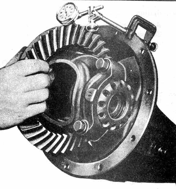

      Checking ring gear runout, and backlash are fairly routine. Follow Patrick's instructions. Kind of fun, really. I used a water soluble "blueing" that is for spotting pieces together and it worked well and showed up on the black gears. I've heard of some people using a little oil mixed with white oil-based house paint. Never tried that, Dykem hi-spot blueing is only about $2.00 at the auto store.
      Patrick speaks about making a final tightening of the large carrier bearing preload nuts (the ones you borrowed the two pin spanners for) – his instructions read "Now go (2) notches past snug". Well, I'm here to tell you that I could only go (1) notch on each past snug, I don't think Godzilla could get (2) notches, at least not with spanner wrenches like I had. Do check backlash again and don't forget to torque down the bearing caps to about 115-135 ft. lbs.
      Your last problem here is reinstalling the torque tube front bushing. Patrick gives you a one-piece bronze bushing about 5.75 long to replace the two bushings that you knocked out with the 6 foot pipe. You have to be careful here, as the bronze is easily deformed and then you'll have a right bugger getting the U-joint sleeve to slip freely in over the driveshaft splines. What I did was put the bronze bushing in the freezer for a couple of hours and then, just before installing it, I warmed the end of the torque tube up with a propane torch. I had a friend hold the OLD torque tube bushing in front of the NEW bushing, and commenced to tap it in with a short piece of 1 1/4" pipe. You want to drive the new bushing in flush with the end of the torque tube. I still managed to raise a burr on the face of the new bushing and the U-joint sleeve wouldn't start. Fortunately, I had a small, flat diamond file that fit nicely between the inside of the bushing and the splined driveshaft end and a five minute touch up had everything fitting nicely.
