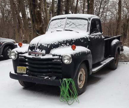

I'll start with a brief story of my life and the build of the truck.  It took me a good six years to get it to where it is today. My first entry in the forums about this truck was November 2010 but I had been looking in the forums for quite a while before I finally posted something about the truck.
I took a pause for two years on the project. There was a time lapse to move, get married, get a house, have the first kid. But most of the big stuff is done on the truck and it's good as a daily driver. And like many of the old truck owners, I'm always tinkering, fixing, changing, adding something.

I immediately started working on it. Everything needed work. There was a substantial amount of rust in the cab. I started welding in new sheet metal while working around the install of the drive train.
Once the engine (Detroit 453t with Clark 280VO 5peed) was installed, I had a pretty good idea for the axles and steering based on Grigg's Mullen's build. I discovered that the steering setup was the hardest part of the whole project -- matching the geometry with the p30 axle to a power steering setup (mid '70s Dodge 4x4 Saginaw box).
After electrical (Painless 12 circuit fuse block) was finally done, glass in, I took it for a test drive and couldn't have been happier. That was January of last year and four years had already passed. The only big thing that happened was the drag link nut ripped because the nut was stripped. The cotter pin was there to stop it. Fortunately, we were on the main street.
I had some alignment issues to fix and plenty of odds and ends. I had a kid from work paint the truck with Tractor Supply enamel. I did the prep work. I'm not good with paint but he was a did a decent job.
I can use the truck for anything and can cruise all day at 70.
Right now I'm working on the finishing touches I guess you could say -- windows and fix the headliner. I have to replace the heater core.
I did a little more tweaks and got some odds and ends fixed. Now I drive it to work everyday -- a five mile commute through the city of Trenton.
I still have a little more interior work to do. I have half of the firewall lined with Dynaliner, and need to add more to the top half. Some of it is road noise coming up through the door and the shifter column which needs a bellow on it. Before it was just bare sheet metal, and you couldn't stand the full RPM, even with the muffler I have on there. Once I started lining it, it was night and day, even a little goes a long way. (You need to hear this! He's not exaggerating ~ Editor) Other than that, I don't know how to quiet down a Detroit.
