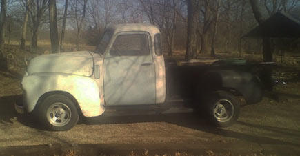

This is my 1949 GMC. I have owned this old truck and been working on it for about 10 years - about as long as I have been a regular on the 'Bolt. I always thought it was a 1950, but title says it's a 1949 GMC..

I have always had an old pickup project of some sort around as therapy in later years, instead of having to keep one running so I didn't have to walk. This Jimmy is not the original Chevy that Dad brought home, but just a look-alike cousin.
This GMC truck was a complete pile of junk when I bought it from the local junk car hoarder. There was no glass. The bed was full of junk. The cab was full of mice mess. It had no tires. The original 228 engine had a cracked block that had been repaired a number of times by brazing, JB Weld, bath tub caulk, epoxy, among other methods. Hard to believe, but I was not able to bring it back to life! So the truck got a 350 engine I built up myself, except for the over-boring. I also added an auto transmission for it.
Working on this old GMC has been good therapy over these years, and has followed me through three house moves. I did all the things for the Jimmy I would have like to have done for the Chevy IF I had had the money, time and skills back then. The '51 has a v8, auto tranny, different rear end, disc brake, power steering, power brakes and such.
It's somewhat of a reincarnation of my first pickup. I'm not one to draw attention to myself, so I probably won't paint this one orange ... but I'm thinking of a black with some orange highlight.
It is finally tagged and legal. It only lacks a temp gauge and a fuel gauge before it gets its first run down the highway under its own power in at least 30 years.
