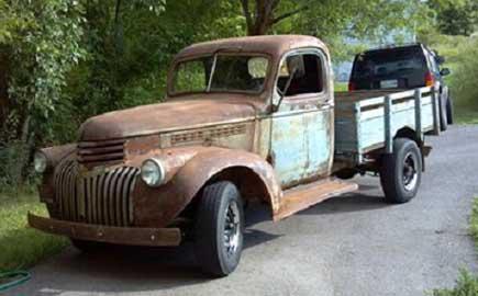

1941 Chevy 3/4-Ton Short-bed
"Ole Rusty"

I struggled with the idea of painting it but so many people that see it at the gas station or a store, say not to change it. One woman actually focused on the broken rear window and said she loved how it looked and said, "Please don't replace it." Another time, I came out of a store to find an elderly lady standing on the running board giggling and another taking her picture. They said not to change it -- they loved its old look.
As I drive around, there are usually horns honking and people waving and smiling as I go by.
One trip, the truck hiccups and starts to die. I give her gas but she just starts slowing down and the motor is just not firing. All of a sudden BUUURRRR, she takes off again and runs fine all the way home. I tucked her in the garage and thought, "Skip, you know better than to drive something this old with no tools, duct tape, electrical wire and connectors, spare tire or jack and you never even put a new fan belt on it." And I did that twice.
Wrenchbender Ret was able to help me with the generator problems.
Another month goes by of enjoying my Mondays with the Ole truck and I decide to do a process i saw on the internet to preserve Rusty's patina. Just this month, I bought two jugs of CLR, a BBQ grill brush and a few gray Scotch Brite pads. I started the process of scrubbing down the truck.
I used the CLR and brush on the heavy rust and the pad on the rest, scrubbing until it foamed up and the pad slid around easy without sticking to the truck. I also used Krud Kutter Rust Remover that seemed to work great. I rinsed and looked at progress. If it needed more, I did it again. (FYI, your hands and fingers may get irritated by the chemicals for such a long period of washing and scrubbing so rubber gloves are probably needed ... just saying from experience.)
It became apparent, as the rust haze started washing away, that the truck had four colors hidden underneath. It had a way of telling a story by the different paint jobs it had over its lifetime. Then I clear-coated it with satin clear and all those years of true patina came to life!
People still say how much they love it and those that saw it before, love it even more now. ( There are some good pictures in Skip's Photobucket of how it looks after all this scrubbing and the clear coating - amazing! ~ Editor )
