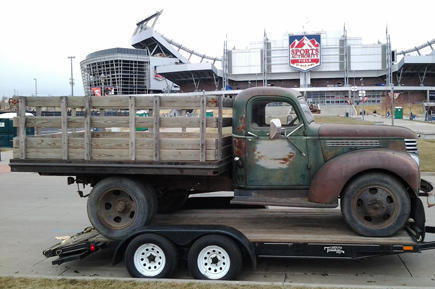

So I started my search. I found quite few trucks that were missing a few parts and needed a lot of work. I saw the this one for sale in Loveland, Colorado back in September 2012. It was a very clean truck with no rust and only a few minor dents -- and all the pieces were there! But, what was I going to do with a ton and a half ton truck with a 9 foot stake bed on it ???
So I kept looking. I looked at a lot of pictures here in the Stovebolt Gallery and a few on the web. The more I looked at pictures, the more this old truck grew on me.
On December 15th, I went to look at it again and decided to bring it home with me. In the picture above, we stopped and parked in front of the Denver Bronco's Stadium on the way home -- to do some Xmas shopping.
We got home, drove the truck off the trailer and backed it into the yard. The next day, my wife and two kids covered the old truck with Christmas lights.
My plans are to leave the rebuilt 235 engine with the 4 speed transmission. I'll swap out the front straight axle with one from a 1941–1946 3/4-ton and replace that 1 1/2-ton rear axle with a 1970s – 1990s dually axle into the back. This will give me highway gears and lots of choices for 8 lug wheels.
The wheels on the truck now are 20" with 7.00 - 20 tires on them. The axles that I can get do not have any wheels on them, so I'd be looking for some. I have checked the local junk yards and the are some 8 lug wheels off of late model dually's out there, just not sure what size to go with yet. I was told to stay away from 16.5" wheels due to tire selection. It will be a few months before I get to this swap, but when I get into the rear axle, I'll be back in the forum with my ring and pinion questions.
I'm thinking about cutting down the stake bed sides so they are just below the back window, similar to a steel sided pickup bed. Not sure if I’ll shorten the wheelbase down from the stock 134 1/2” or not.
