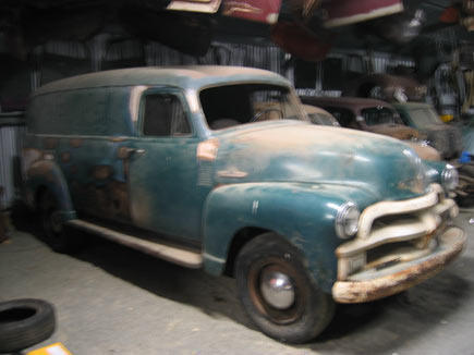

Marge is our 1954 1-ton wagon (panel). We picked her up in 2000 and she has been an on and off project as other things get pushed ahead of the line.
Her left hand side was clearly smacked the whole length of her. This was a serious learning curve on how to do this correctly.
Now (2012) she is on the home straight to finishing as we speak. Fenders are prepped for the Orange to finish her off.
We installed a 1962 261 rebuilt motor with triples carbs and Fenton headers, 4 speed Saginaw to 3.08 12 bolt differential. We dropped on a set of '59-62 hubs and drums to 6 stud and used the same leaf springs to give a softer ride. We also lowered the panel about 6'' by changing the set of originals 15'' Auliteries rims. We found they were also painted orange to match the body.
The entire truck was taken back to the bare, to start the big job. Every nut and bolt was replaced to original bucket seats that we still have , with a pickup frame. The seat fits like it was meant to be there. All the glass is tint bronze.
