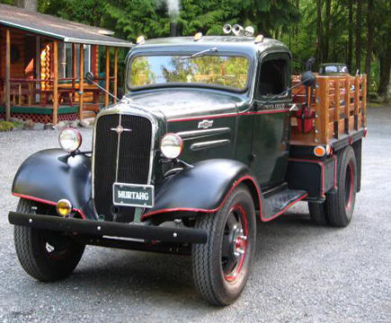

This is my wife's 1936 Chevrolet 1.5-ton short wheel base truck. We found it under a shed in Bellingham, Washington. I bought it for $650 and we trailered it home.
Toni, my wife, immediately decided it was her truck, and since I love her to death, I agreed.
We took the old truck down to bare frame and started the rebuild.
I replaced the blown 207 with a custom-built 1955 235 full pressure engine from my awesome Brother Dan (Baldybenny on Stovebolt). Using a bell housing from a fellow Bolter, Bobb (3B), I was able to keep the entire driveline original.
If you didn't take a chance to look through Jim's photo album, you may enjoy the enlarged image of the truck on this page. It's a beautiful setting. And we used this one for a cover ... as Toni was waiting for her engine! ~ Editor
Toni can double clutch and shift square gears like a pro. She grew up on 40 acres and drove old tractors. She's a natural and the little 1.5 tonner feels like a half-ton pick-up.
The Chevy can do 55 mph all day long and I know we've gone faster.
It took 3.5 years for the rebuild and Toni wanted the original patina, so no paint or body work was done.
I insulated the entire cab under the interior sheet metal and that makes all the difference when you drive it.
It has a 12 volt system with 1970 alternator and wiring harness.
It is extremely dependable and a blast to drive.
I have a total of about $4K in it but it's invaluable to us.
