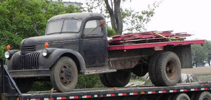

I found this old 1946 Chevy 2-ton flat bed truck in a barn near Shelby, Ohio. This truck was complete. I thought it would make for a great project. I also found a second awesome truck -- a "modified" 1946 Chevy 2-ton school bus. The bus came with another 1946 Chevy 2-ton that was mostly just a cab and various parts that had been squirrelled away in various parts of the old farm (as you can see in the image - sitting on the back of the bus frame).

The 2-ton classic truck I'm focusing on has a 12' 3" platform bed with removable grain body sides, and a 216.5 engine out of a 1950. Also included in this sweet deal was the stock 4-speed with the hand-brake, the "Super Deluxe" heater and 8.25 x 20 tires (rear) and 7.50 x 20's up front ... all of which hold air!
Best of all it only took a 6-volt battery, coil, fuel pump and fresh gas to get this old truck running!

I have a picture in the Photobucket titled "Road Test." This was when I first brought it home and it was the first time for that truck to drive down the road in 35 years. This truck restoration is so close to being done!
