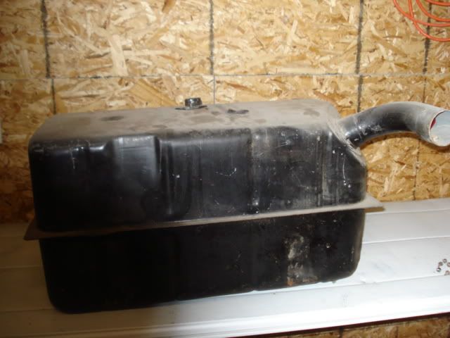

Here's a picture from bowtietims suburban. It's a new tank from Jim Carter. [font:Arial Black]BOWTIETIMS TANK[/font] * [font:Arial Black]HIS ALBUM ON THE GAS TANK AND STRAPS[/font]
[font:Arial Black]ACHIPMUNK'S ORIGINAL 16 GALLON TANK[/font]
[font:Arial Black] 1953 PANEL'S ORIGINAL GAS TANK
Tim Lederman had posted THIS ONE from a 1954 1 ton Panel. Chevrolet called it a 18 gallon tank.

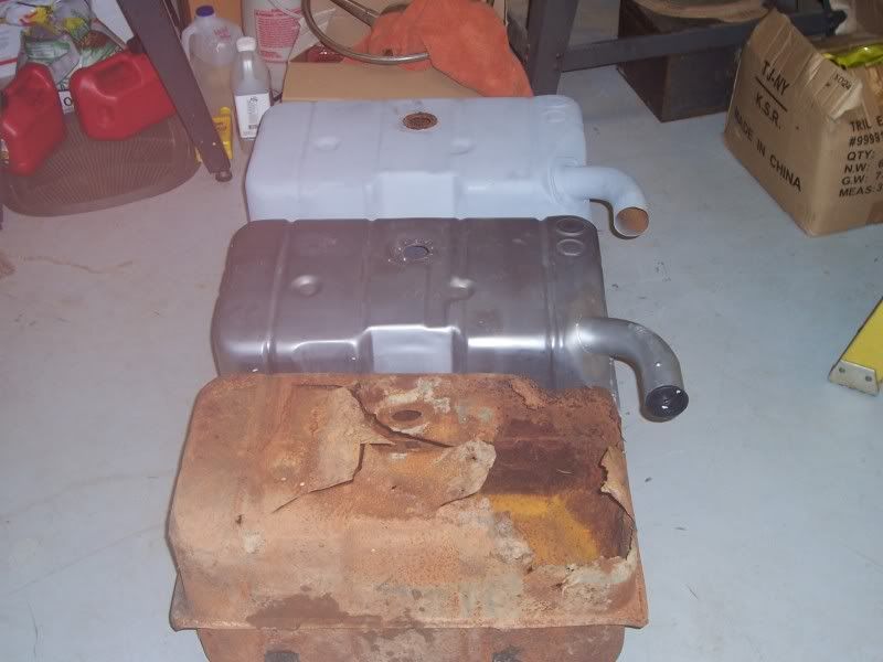

Interesting the slight difference between mine and Alvin's tanks. The canted section near the top is in a different position.
OOOK guys. Let me muddy the water....or perhaps help clear it up some.
When we refer to "MY" tank it is NOT off a PANEL. I got this tank from Mike at the Stovebolt Reunion in 2008. My ORIGINAL tank I took out of my panel is just about totally rusted away.
So, "my" tank may have been out of a SUBURBAN rather than a panel. Leo, that may be why you see a "canted" section near the top that is differnt than yours.
To help us out on this I am going to get my ORIGINAL tank, the one from Mike (suspected Suburban) and the NEW one I bought from JCarter for my panel and take a picture with all three of them in a line. I will come back and post the pic here.

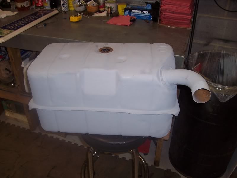

There were slight differences in the gas tanks that we scrapped (didn't take pictures.. dope! dang ) between the 1947/48 truck gas tanks, the 1947/53 Panel/suburban gas tanks and the 1954/55 Panel/suburban gas tanks. I did notice slight differences in dimples/creases and indentations. They looked like they would all interchange with each other, with slight modifications to each. The 47/48 truck tanks had different filler tubes an the 1954/55 panel/suburban tanks used different sending units and no longer have the fitting on the side for the gas line.
I will see if I can get the different tanks side by side for caparison and pictures.

OOK. Here we go.
#1. old tank is the original rusted out in front off MY panel.
#2. is a new tank recently purchased from JCarter
#3. is the primered tank I bought from Mike Taylor 2008 before repop's were made. ** It could be a suburban tank??

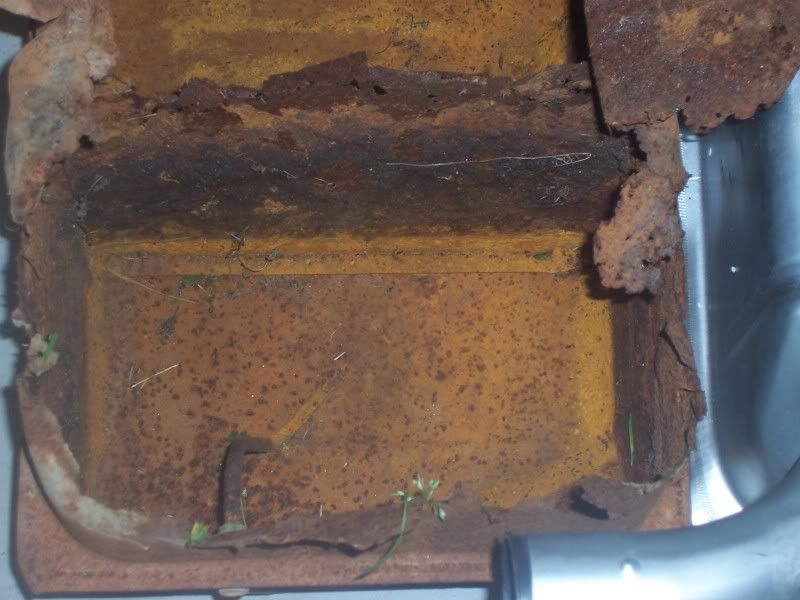

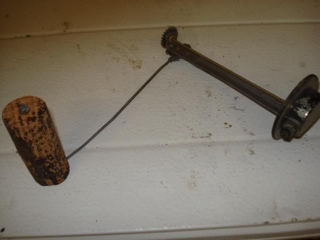

Observations: the original rusted out tank has a baffle 9" from the end where the pickup line is located. It is a solid baffle. I used a 1/8" wire to confirm it had space UNDER it for gas to flow to pickup tube.
NOTE: one of the pics shows the pickup tube which is "bent" down to the bottom and is tack welded to the bottom.
The other picture shows the baffle itself. Now, I stuck the 1/8" wire down through the gauage opening and with a flashlight could see the wire actually go UNDER all baffles so the gas can flow to pickup tube. Only ONE baffle in tank.
Any other questions before I throw the rusty one away?
Hope this helps and you can get the pics open. IF not, go to my photobucket below and it will be the first 4 pictures on page one.... theres a few updated pics in their if you care to look.
