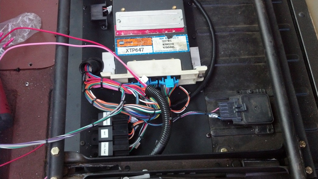

Thanks! Starting to get serious about the wiring!
Posts: 4,252
Posts: 4,252

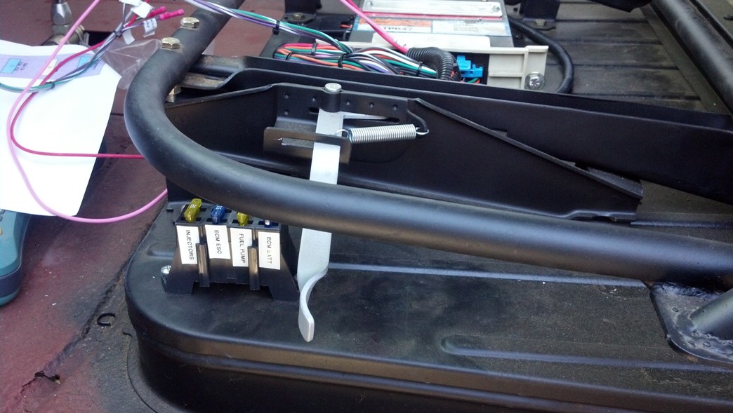

Well, got some wires up through the floor to mount the fuse panel and computer under the seat. I need to make a plate to cover the tool hole to mount everything on top. I'm going to have a real minimum approach to wiring with capacity at the fuse panel to add when I have to. I have an October deadline. My buddy is threatening to get an era correct station wagon to use as a push car if I don't get this thing going. Unfortunately, that dragster also requires a lot of work and the funny car needs to be ready for October, also.

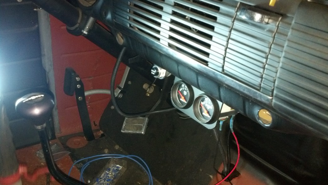

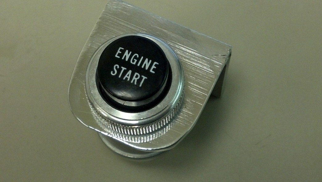

Got a start button: http://www.bunchobikes.com/1952suburban137.jpg
And some gauges ( until I have the originals updated ): http://www.bunchobikes.com/1952suburban138.jpg Start button mounted.
I still need to order the fuel pump.

Okay. Got the fuel tank back in. Got all the ignition wiring done. Found a way to properly install my idiot lights. Cranked for oil pressure, put the prom in, put all the fuses in, key on for fuel pressure. I can hear the pump whirring, so that's a good thing. Checked the schrader at the rail and I have fuel ( with pressure.) Boy, you can smell the varnish! That worries me a bit more as the injectors might be sticky. Now, I know I said I'd take video of the first fire up, but I want to crank it to see if it would even catch. So I crank. Very tiny signs of life. Mechanics 101. Check for fuel, check for spark. I do two birds with one stone, I throw some ether down the throat. Yeah, it has spark. It kicks over good. So those injectors must be stuck.
I spray ether and crank, spray either and crank, etc. It's actually to the point where it will start on its own and idle roughly. But there are still some stuck injectors. Between the heat and the work, I'm feeling pretty beat. Me hands hurt a bunch too. So, I have it on a rough idle and you can really hear the air draw through that K&N filter. I can also hear a knock coming from the passenger lower area??? Remember, I'm on the West coast, and I bought the engine / trans from back East. Supposedly good condition with only 88k on it. I haven't run this enough to really warm it up. I also still have a little more cooling system work to do. Set up the fan, find a place for the temp sender and install the overflow. So I really don't want to run it just yet until I can see what the temp is.
The engine showed up dry but the old filter with oil still in it was on it. I still have that old filter. So I cut it open to see the contents. No metal, nothing abnormal. Definitely no bearing pieces. So, I need to do something about my cooling issues. Then I want to run that motor through a heat cycle, see if it will loosen some stuff up. Who knows what moisture or whatever got in there while it sat when I owned it. I mean, I kept it covered when it rained, but I did have the headers off and exposed throttle body. Maybe that "knock" will go away.
I'm tired. This was stuff I did over the past few days but today I spent the whole day not doing anything. Did I mention that I also worked on the dragster putting the blower back on, new header and some other stuff. Actually, today I measured stuff and started making my next parts list. And I managed to break the overflow nipple at the cap housing. Gonna have to fix that.
On a positive note, at one time I put it in gear and I could feel the transmission engage. That and the idiot lights look like they are working. The CEL goes out after the engine starts running and so does the generator / alternator light. I haven't checked voltage yet, but I'll take it as a good sign. Yes, it is the alternator that came with the motor.
Your thoughts?

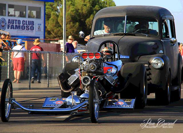

Well? Made it here in one piece. No issues to report. Tomorrow will be some pushcar practice.
Posts: 4,252
Posts: 4,252
Yesterday, I got to push start the fueler on a practice run. THAT WAS COOL! This is going to be fun. I hear this can be watched live on Bangshift.com The parade of cars starts at 6 pm Pacific time, Saturday. There are a few Stovebolts here and there doing push duties. There is a panel around here that, if it wasn't a panel, could be a twin to my ride. I think I'm the only AD Burb here. There are other Burbs.
Posts: 4,252
Posts: 4,252
Story to follow. We are the third pair down. If you watch long enough, you'll see my ride 2 more times as I was voluntold to go push another car.
Posts: 4,252
Posts: 4,252
Me doing my job:
Me doing more work: http://www.bunchobikes.com/1952suburban159.jpg

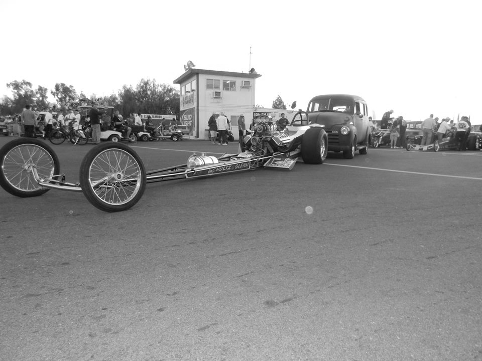

In the Suburban, I have the Crew Chief, the Crew Chief's wife, the owner, his wife and me. Since we are going to push another car, the Crew Chief is going to roll out of the Burb as I drive past to go to my next push. I ask the owner of the dragster to stay with me in case I need any help at the other end. The ladies stay with us too. I only have the front row and the middle row. Enough for all of us.
So, the dragster fires up. I follow him but then I need to stop. That darn dragster is so long it won't make the turn back up the track. It needs to be pushed back and turned again. Up he goes. Now, the volunteers or workers aren't clear on how things work. Half of them want me to go on the other side of the wall where most of the push cars will end up going. The other half say, "No. He has the '2'! He goes up the track!!" I follow the dragster up the track. Our driver makes his way down the track and turns in to his spot as directed. I slow enough for the Crew Chief to get out and I continue down the track with the rest of my passengers. Hey! First time I've ever been down a drag strip and it's in a 1951 Chevrolet 3106!!

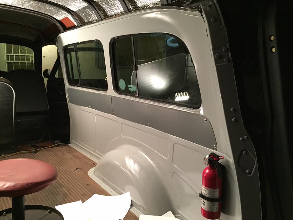

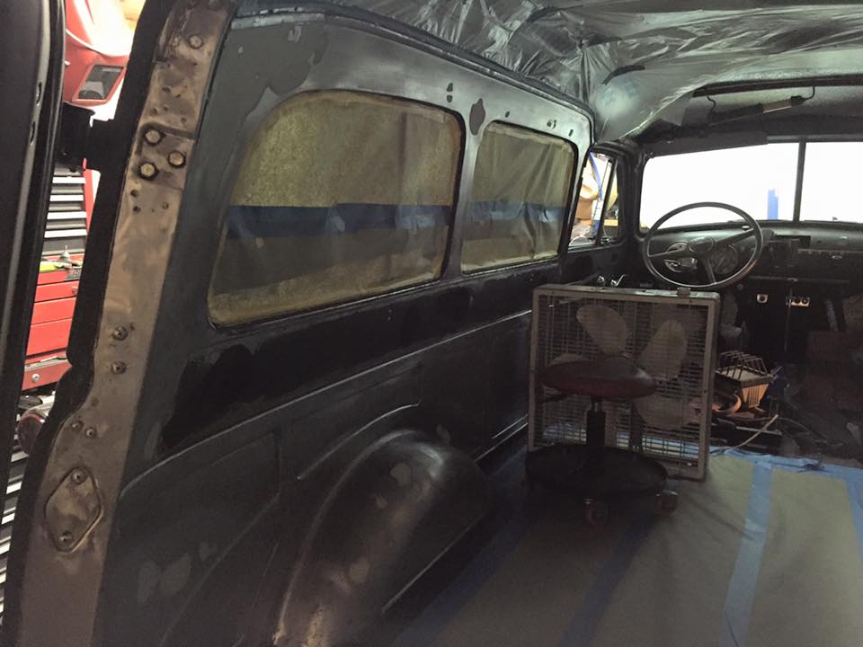

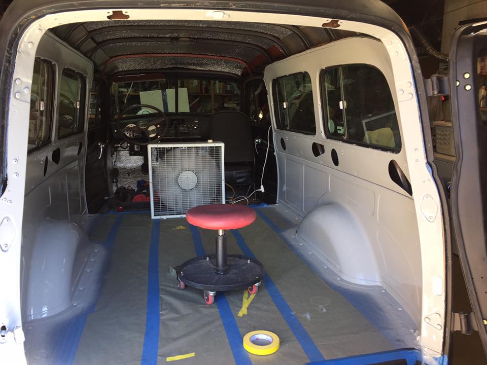

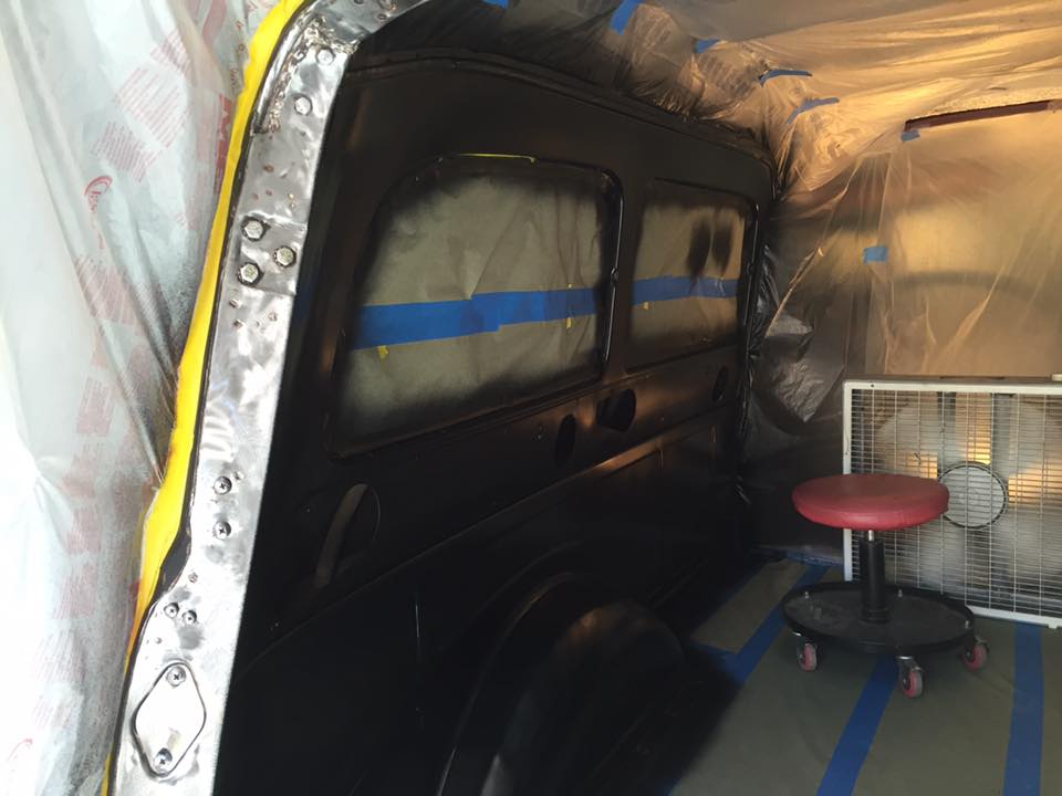

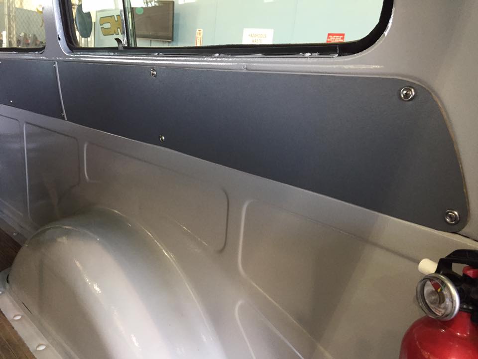

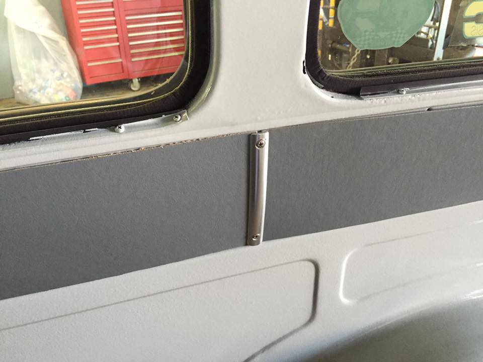

Been a little while. Just painted the inside rear walls. Small parts and trim are at the powder coater.
need some pics when he powder coated pieces come back.

Good work Mark. Doggone it, some guys have all the talent!!
