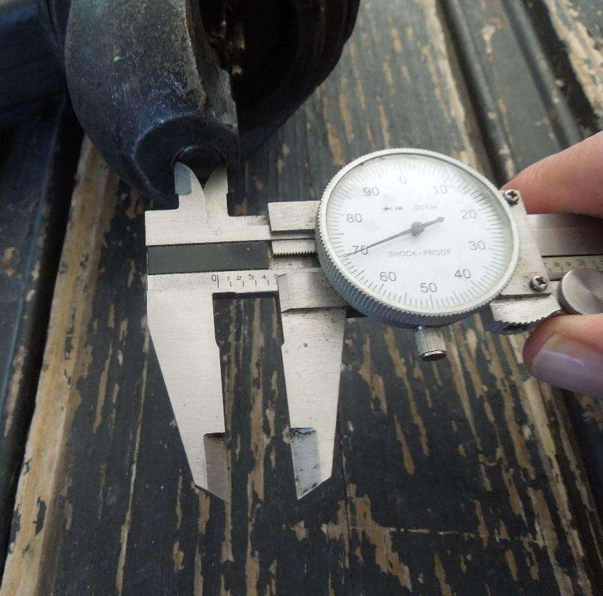

Measure the inner diameter of the bushing at the flywheel end of the starter. The measurement on a 12-volt starter (shown here) is about 0.470” while a 6-volt starter (not shown), measures about 0.502”.

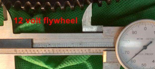

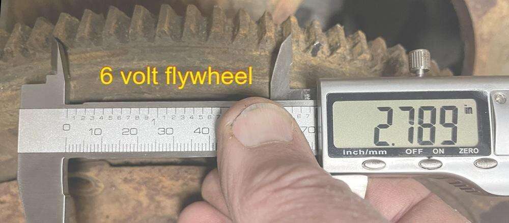

You’ll just need to crawl under the truck, pull the flywheel pan from the bottom of the bellhousing and measure from the top of any tooth to the top of a tooth that is nine teeth away, as shown in the two pictures above. On a 12-volt ring gear, the distance will be about 2.363”. The same measurement on a 6-volt ring gear will be about 2.789”.

I think the measurement of the flywheel teeth should say across the tip of 10 teeth instead of what it says 9 teeth. The picture also shows 10 teeth.
Jay D.
