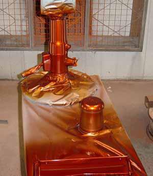

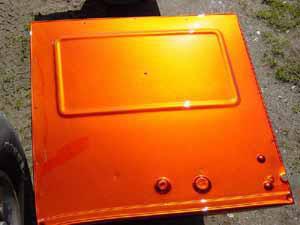

Well, we got some color sprayed last night and still have the clear coat to go on. Here are some pictures.
I made up the color myself. I just wanted to show you so you got the idea of the process. There are three coats of base with five coats of orange glow over top. The interior pieces will get two coats of clear with the exterior getting four coats of clear. |
The base color is a metallic color with pearl and the orange glow that goes on top is basically clear coat with orange dye. The goldish color is just what happens when the light hits it, so it should be easy to see coming down the road on a sunny day.

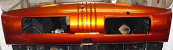

The dash insert (left) is a solid piece of aluminum I had custom made by Nickel
Machine and Tools (2513 Alberta Road, Centerville GA 31028) to fit the curve
of the dash exactly. (He is a really nice guy to deal with.) It has TPI Tech
gauges.
Since the metal work has been done, I have been spending many days water sanding. I can't believe how many nooks and crannies there are. The cab has been sound deadend and insulated and just about everything is in finishing primer and we should be squirting some color (electric orange - metallic base with a orange glow top coat) soon.
