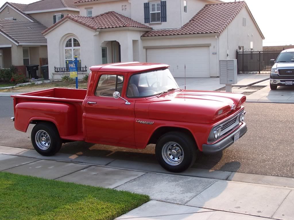

hi , my 59 still has the original and working hand throttle and knob connected to carb , just ask and i will send a pic for anyone, cheers , stevie-t
#228472 Wed Mar 07 2007 08:33 PM
Posts: 18
Junior Member
hi , there is a pic of dash , click on description, if you need a pic from carb side, just ask, as it is connected and working as new

That truck is a wonderful resource for those of us with Task Force trucks who want to restore to original. It really helped me to see the exact paint scheme for the interior. Even though mine is a 58 Fleetside, the more pictures the better. Do you have an account with one of the free picture hosting websites that you wouldn't mind posting the address to?

Lumbergh- Stevie-t's truck is a time capsule, and a beautiful one at that. I echo your comments. No hijack, no foul.
