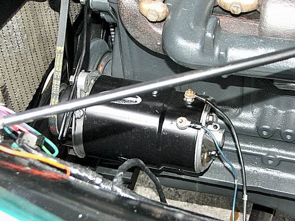

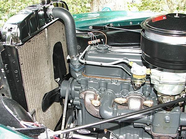

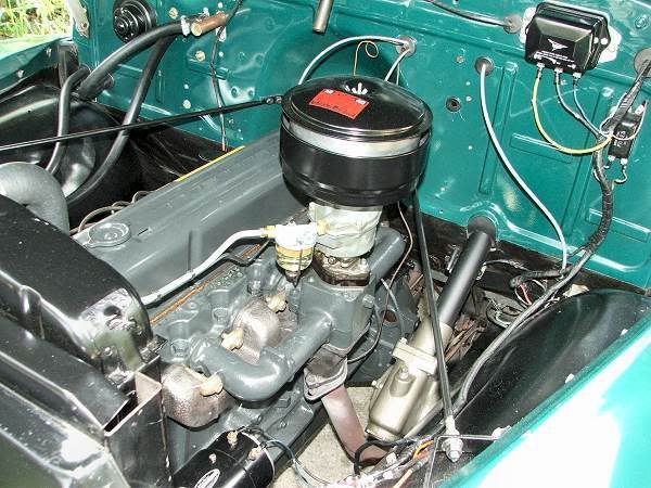

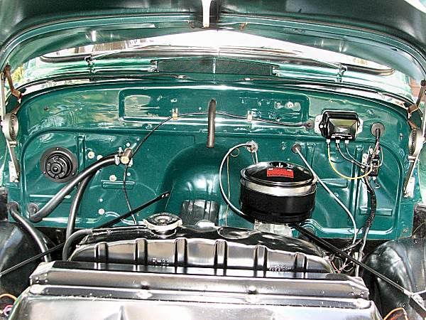

I finished painting my engine and engine bay with the engine in the truck. Not a speedy task. Seemed like I would spend a couple of hours masking, then paint for a few minutes. I removed most of the parts to clean and paint off of the engine. Didn't remove the carb or lines because I didn't want to create leaks. Thanks to DavidF for the aluminium foil masking tip in another thread.
I used almost three rattle cans and a quarter of a pint of brush-on of Filling Station engine paint. I found some areas on the engine that I missed. Can't touch them up now - already getting oil on them from oozing valve cover etc.
I thought that I had the job planned out pretty well, but I ended up masking and painting multiple times in the same areas. Suggest painting the frame areas first, then the engine, and the inner fenders last. (I painted the engine first.)
Used Calyx on the rusty exhaust manifold. Looks great and was simple to use. Also used it on accelerator, brake, and clutch springs.
Here are the paints that I used:
ITEM / / BRAND / / PART # / / DESCRIPTION / / SHEEN / COLOR (Notes)
Engine / / Filling Station / / FS-359 & FS-119P / / Engine Enamel / / Dark Gray
Generator / / Dupli-Color / / DE1635 / / Engine Enamel / / Ford Semi Gloss Black
Starter / / Dupli-Color / / DE1635 / / Engine Enamel / / Ford Semi Gloss Black
Generator Brackets / / Dupli-Color / / DE1635 / / Engine Enamel / / Ford Semi Gloss Black
Starter Rods / / Dupli-Color / / DE1635 / / Engine Enamel / / Ford Semi Gloss Black
Heater Hose Bracket / / Rustoleum / / 7798830 / / Protective Enamel / / Semi Gloss Black
Frame / / Rustoleum / / 7777830 & 7777502 / / Protective Enamel / / Satin Black
Steering Box / / Dupli-Color / / DE1651 / / Engine Enamel / / Cast Coat Iron
Inner Fenders / / Rustoleum / / 7777830 / / Protective Enamel / / Satin Black
Headlight Buckets / / Rustoleum / / 209584 / / Automotive Aerosol / / Semi-Gloss Black
Headlight Inner Bucket / / a coat of Rustolium aluminum and a mist of Rustoleum Galvanized
Fan / / Rustoleum / / 209584 / / Automotive Aerosol / / Semi-Gloss Black
Air Cleaner / / Rustoleum / / 209584 / / Automotive Aerosol / / Semi-Gloss Black
Coil Bracket / / Rustoleum / / 257884 / / Automotive Enamel / / Gloss Clear
Coil / / Dupli-Color / / DE1635 / / Engine Enamel / / Ford Semi Gloss Black
Radiator / / Rustoleum / / 7798830 / / Protective Enamel / / Semi Gloss Black (Similar to Auto Semi, I had more Protect available)
Steering Column / / Dupli-Color / / DE1634 / / Engine Enamel / / GM/CHRY Low Gloss Black Flat, slight grey tint - similar to column inside cab)
