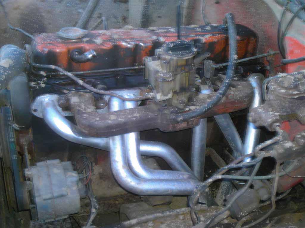

Body work aside, there has also been modification to the driveline, which consists of: 292 L6 SM465 4 speed some transfer .. I think 205. 4.56 or 5.13 rear end headers installed. Currently awaiting the installation of my Offy 3x1 intake.
Well, when spring rolled around and body work failed to keep my attention, headers were installed, and voila! Instant fun!

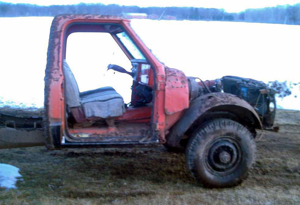

Now, the front driveshaft is currently sitting on a back shelf, so 2-wheel drive was the only option,
along with having no front sheet metal aside from the newly acquired and painted '68 rad support. No other sheet metal besides a cab. My cousin and I were in for a good time as the frost broke, and snow melted. We had ourselves a mud drag strip. Now, before anyone worries about safety ... well ... we all do stupid things. No one got hurt. So ... no worries! ![]()
