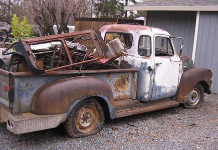

So last year, we rescued three of these trucks from where they had been parked outside for over 30 years. We trailered this one home (that's why there is so much stuff in the bed in the picture above!). This one is our restoration project. The truck is basically complete. One of the trucks I gave to a friend and sold the other one after removing some of the parts for this project. We have extra parts that dad collected in storage and will keep what we need and sell the rest. We can use that money to put back into the restoration.
