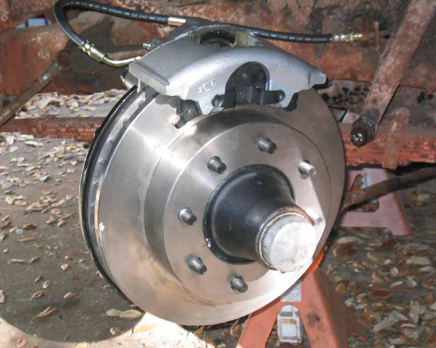

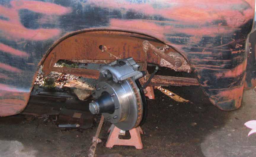

I have finally had time to take some decent pictures of the progress I have made on the truck. I have scratch-built a disk brake conversion for the front and replaced all the wheel bearings and seals. (Here is the front rotor and the caliper.) I also found a set of bias ply tires after about five months of searching. I found them at little tire shop in Bandera, Texas that had a full set sitting on their shelf for who knows how long.

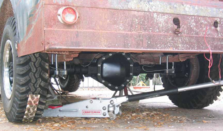

The rear axle had to be replaced. (Here is the new one.) I pulled the drain plug and all that came out was water. So it had been making a nice rust stew for the past decade or so.
I fitted a 1995 2500HD axle (posi) with a 3.73 gear ratio so it should be a little more enjoyable to drive at highway speeds.

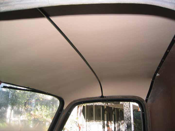

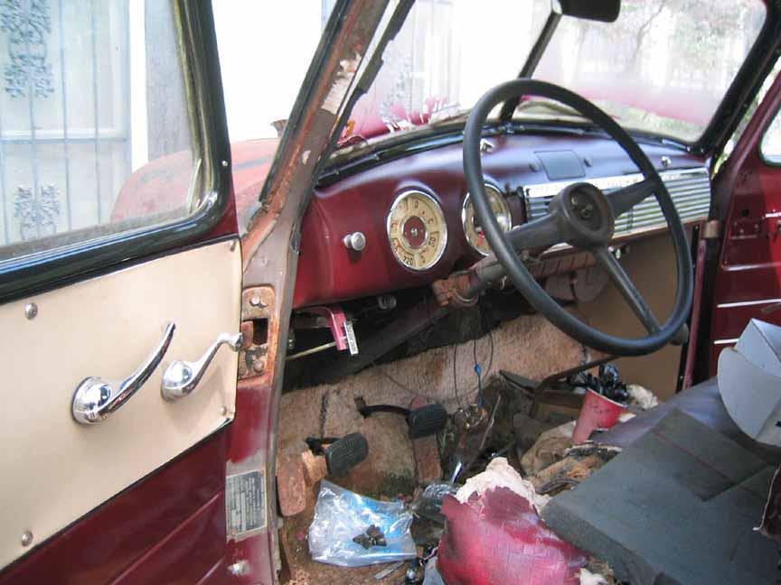

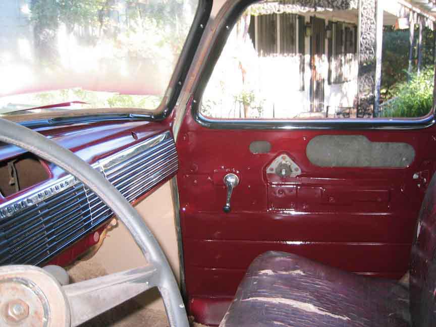

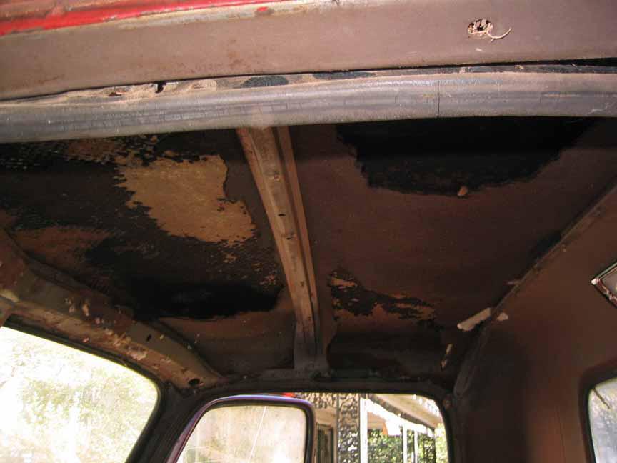

I have put in a new headliner (here's the before picture) and added new gauges. The interior is coming along.
