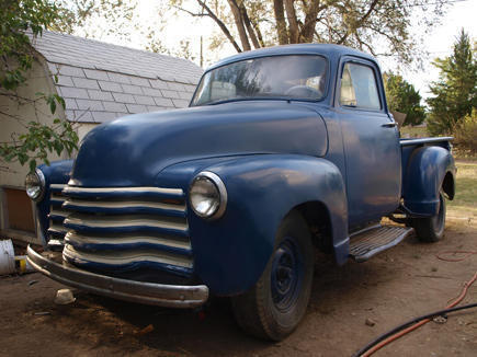

When I got home, I told my wife about the pickup. She and I drove out and looked over the truck.  I explained to her that I had a front clip that could fit right on it.  It wasn't a 1954 NOR a GMC. It was from a 1950 Chevy.
After she and I looked it over, she agreed that it would be a nice project. On the way home I stopped by the bank and took out the cash I would need to as a payment.
The next morning on my way to work, I stopped by the school.  I told the shop teacher that I had his payment.  He asked me if I had a trailer to haul the truck home.  I told him that I was going to make arrangements with a friend.  He pointed to the school's car trailer and said I could use it.  I thanked him and handed him the payment.  He counted the money, then handed me back $100 dollars, and said, "I thought we agreed on $600.
Since I've had  the pickup home, my Son and I put the body together. I had my son help me knock dents out of fenders and other body parts. We replaced the entire wire harness. We built an exhaust system.  We replaced the rear end with a six lug 1972 Chevy rear end.
There were pin holes in the gas tank so I repaired them. The master cylinder and brake lines had water in them so I completely went thru them.
We replaced the gauges.
When it was time to paint the pickup, my 12 year old Son wanted to help. He liked doing the engine work but wasn't to keen on cleaning the gas tank. He wanted to learn how to paint with my paint sprayer and I used this opportunity to teach him. I guess it looks good enough. There are a few places that didn't come out as well as I wanted.  I did get something much more valuable: I have a memory my Son and I will always share.
I named the old truck “Gert” in honor of a fellow soldier I had served with.
We now have a complete truck. A little 1954, 1950 ... GMC and Chevy.
