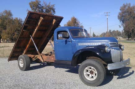

I was home for Thanksgiving and I figured I would slap some paint on the old truck. It's always been in a sort of rough primer / body work phase and the engine bay is still the original blue. I just wanted the whole thing blue! Went down to Lowes and got some rattle can that's close-ish. Its not amazing in quality of work but it is amazing to finally see it blue! That's the picture above.
