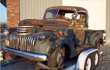

It started in the summer of 2011 when my Father-in-law asked if I wanted to help build / restore an old truck. It was a local truck for as long as I remember. My FIL drove by in town one day when he spotted it for sale.
I have always been the do-it-myself type (for the most part). So even sight unseen, I said "Yes."
The photo here is what I first saw when the truck was brought over. It definitely needed some TLC. There are more pictures in the Photobucket album, of the progress and a few key moments in the process.
