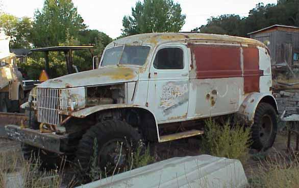

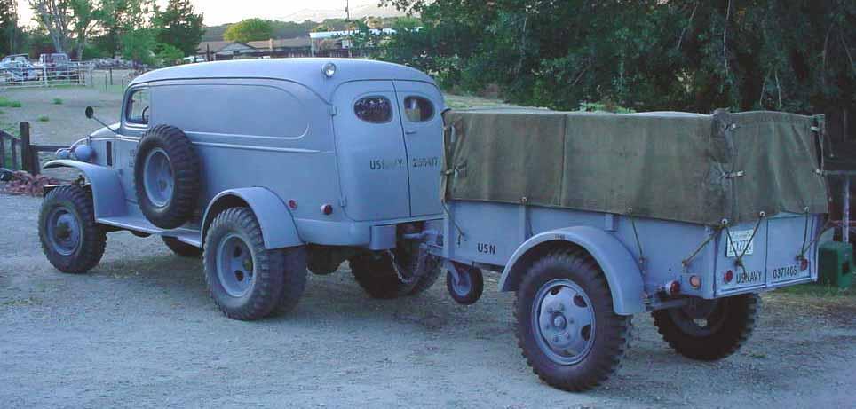

Last year, I just finished my 1942 1.5-ton 4 x 4 NAVY Chevy panel truck. I thought you might want some pictures of this truck to add to your Gallery. It is all stock except for a TBI 350 Chevy motor and a New Venture 4500 (5) speed transmission. I found the WWII 1-ton trailer in northern California independent of the truck.
Two weeks ago I did go 4-wheeling at Camp Roberts Military Base where I did at least a 45% climb with the truck with no problems at all. In fact I stopped half way up and shifted to second gear and continued to climb.

Our panel truck was used by the NAVY from 1942 to 1954. Where the truck was stationed is not known. The Lampman family bought the truck in 1967 in Southern California. It was used off road in the California’s deserts until 1971. From 1971 to 1992 the truck sat unused and in a state of decay. In 1992 the truck was moved from the desert to San Luis Obispo County (CA) where restoration began. Restoration was completed in 2006 when it took its first trip to the 1st. annual Camp Roberts MVCC encampment.
