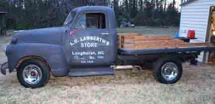

The guy told me what the owner wanted for it. I gave him a call and got it from him. [ The before picture ]
This Advance Design truck was an original 3/4-ton stake bed. It was rusty. The cab corners were rotted out. The stake bed wood rotten. The tires had dry rotted on it with no miles. A friend helped me get it home on a trailer.

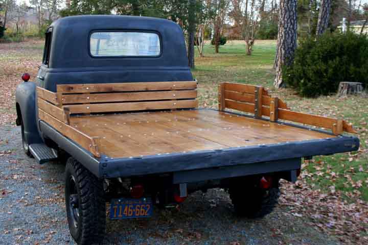

Then the bed ... we started disassembling the stake bed. The outside frame was good but all the other was rusted out and rotten. My friend works at a manufacturing plant and he drew the metal frames out and had them made on a fabricating machine. While they were being made, we removed the rust and primed the frame. We then assembled all of the metal parts on the bed.
Another friend is a cabinet maker and he planned the Oak boards that came with the truck. We stained and polyed them and put them on the stake bed frame. We drilled 100 holes and mounted the boards to the bed. [ Picture from the rear ]

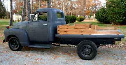

We made side rails for the stake bed and installed them. We found some Dodge Ram wheels, 8 lug that would fit and put them on with some used, nice radial Michilan tires. [ pix ]
We entered the truck into the local Christmas parade. We decorated the like a 1950�s Christmas. My Grandfather ran a store in North Carolina and we put a tree across the top of the cab and put old antique toys on the back of the bed. It looked really good! We won 1st place in the antique vehicles.
I do have a web site for the '53 and also my wife's 1966 Mustang!
I have fallen in love with the truck and I now call him "The Old Man." It's not painted pretty or anything, but we placed lettering on the side of the doors like they did in the 1950�s.
