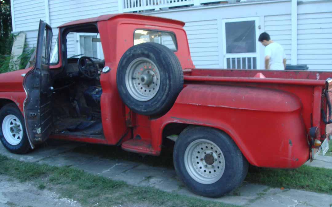

           The project is coming along, slowly but surely. I sandblasted, bondoed and primed the big hole in the roof.
           I fixed a leaking gas tank. Shortly after I got the truck, I tried to gas 'er up. As I'm filling the gas tank up, I look down to see a puddle of gasoline around my feet. Needless to say, this quickly became a top priority to fix.
           The first thing we did was rip out the bench seat. Once we did that, I found the culprit. The fuel hose that connects the tank with the filling cap was dry rotted. Gasoline flowing down the tube would flow around the tank and into the cab. From there, the fix was pretty straightforward. There was also a paint stirring stick in there. Don't ask me why.

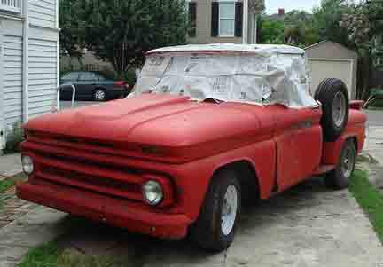

           This is my 1962 Chevy Stepside. That's me behind the wheel in the picture. I'm a mechanical engineer, living in New Orleans who was looking around for my first project car when I found this truck on Craigslist. I went and checked the truck out and it was in decent shape. No Katrina damage.
           The truck needs some electrical work. I need to replace the leaky gas tank. It needs some body work. Here's a view from the driver's side.
           The engine isn't original. It's a small block Chevy V8 (350 cid). It also has an automatic transmission. All in all, the engine and transmission seem to be in good shape.
           I bought the truck from a landlord who acquired it from a tenant who was behind on his payments. The truck was used as a dragster by the tenant. The landlord was intending to restore the truck, but never did. His wife finally made him sell it.
           Many weekends shall now be sacrificed on the altar of the '62 Chevy pickup...
