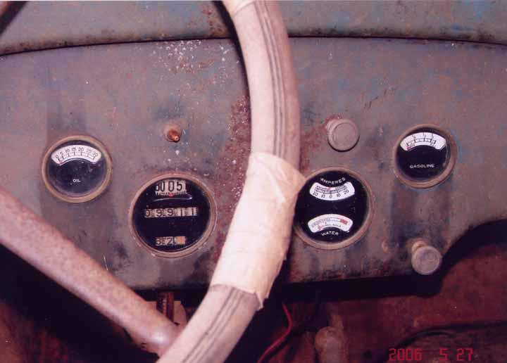

           It is an all-original, one owner 1930 1.5-ton Chevy log truck with 9911 actual miles. It was bought new by the "H.S. Construction and Engineering Company" in 1930 and shipped to "Nabors Trailers" in Mansfield, Louisiana for a custom built fifth wheel trailer and winch.

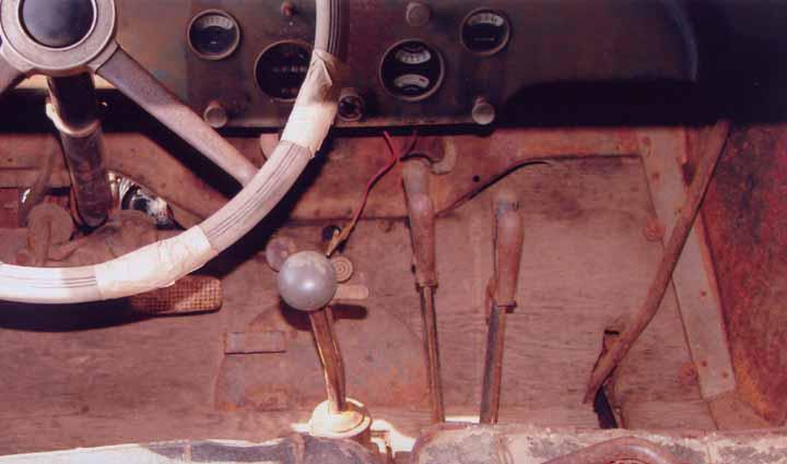

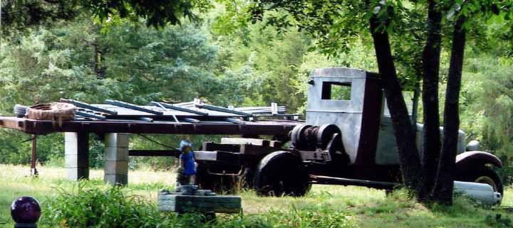

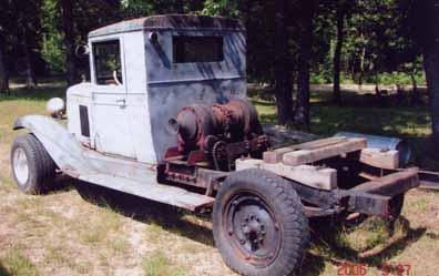

           The winch is the model "c'' serial #262 5000 lb pto winch by the Automotive Division of Muskogee Iron Works from Muskogee, Oklahoma. They went out of business about 15 years ago. The belt goes on the left side of the winch. It is not an actual drum, like the John Deere tractors. It is just a "u" shaped end similar to a pulley for a fan belt. There are several levers in the floor that operate the different functions. The cable appears to be several hundred feet long.

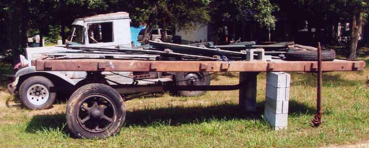

           The trailer has removable side boards which are stacked on the trailer in the picture. It has a slider rear end on the trailer, with 4 positions. The springs are sideways like on a Corvette and the frame is flexible, perhaps for crossing rough terrain and ditches. There are two layers of wood, with the top layer tongue and groove.
           The truck vin numbers say it is a '30 but the back corners of the cab are squared off like a '29. I was told that it was a '29 leftover and retagged as a '30 to keep from taking a loss from the factory. It also has the downdraft carb under the intake. I`m only guessing, but it sounds logical to me. The '30s that I have seen are rounded at the back corners of the cab.
