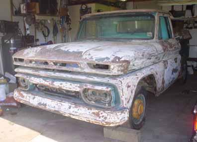

Here are some pics of my 1964 GMC 1/2-ton Fender Side Truck. It has a 230 inline 6 Chevy engine.
We came by this truck while actually looking at an early 1970s model truck at a car lot. I mentioned to the owner that this truck was out of our range, but if he ever found an older truck that needed work at a good price, we would be interested. He informed me he had this 1964 GMC truck in his barn at home. He asked if would we like to take a look at it? It turned out to be a great truck style, from the South (hardly any rust) and in quite good shape for restoring. We purchased it on the spot. Since it wasn't running (and not completely put together), we towed it home on a trailer. We weren’t thinking a total restoration, we just wanted it to look and run decent for us. I like old trucks and I figured this truck should easily tow our 13' vintage 1963 Shasta trailer with a weight of 1400 (minus water).

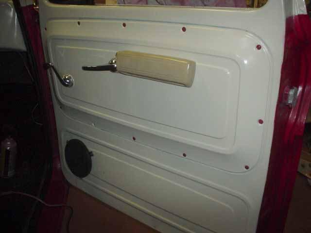

We still had to buy all new rubber trim for inside the door, get the new windshield in and do something with the wood bed. I was still stumped on what color to go with on the inside, but the non-original aqua green would have to go. After much thought, we decided sticking with the almond color of the cab would look the best.

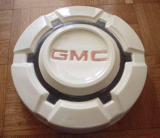

Since we changed the rims out, we will only use a GMC hubcap on the spare. (Bev, you have to tell us where you found that COOL hubcap!! ~~ Asst. Editor)
