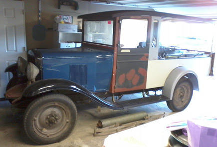

I have casually scanned classifieds, online ads and auctions, just to see what was out there -- not being in a rush to get anything. Recently, I came across an ad for a 1930 Chevrolet Universal AD - Canopy Express Truck / Huckster partially restored and it caught my attention. This old truck unique in a way all its own. So I contacted the seller and inquired.
Well after a few weeks of working with the seller, finding and setting up transport, and getting all the ducks in a row, the truck was finally delivered in June 2012!! It was now it its new home -- my garage.

Now to figure out where to start. My plan was to catalog and take inventory of what I have on hand. I will also do some research and try to figure out HOW this thing goes together as it is currently in pieces.
My son and I unloaded the truck, sorted out the parts and pieces and laid them out on the workbench and floor. Looks like we have a lot of pieces, some even duplicated. We found out some pieces we were missing, and made a list of things to look for.

The next step was to rent / borrow an engine hoist to remove the engine from the bed, so we could get it ready to attack.
I would like to dry fit everything together to see what I have, what I need, and what needs to be done. Then I can start to disassemble, fix, work, replace, or repair parts that need attention. Then I'll completely reassemble the truck and do the fine detail work.
In January I spent a Saturday working on the frame, stripping it down and putting a coat of primer on. I got about 20% done, taking my time and trying to do it right. It was the first time I had ever attempted anything like this. Also I am doing this with an angle grinder and wire brushes, as well as by hand in the hard to reach spots. Yes I was wearing PPE, safety goggles, face shield, respirator and long sleeves and pants. Wires and paint were flying everywhere !!
