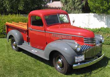

      Well it's been 4 1/2 years and my '46 1/2-ton is finished. (I think.) This has been a fun and sometimes frustrating project. I'm glad all I have to do now is tinker with it. They're never really finished you know.

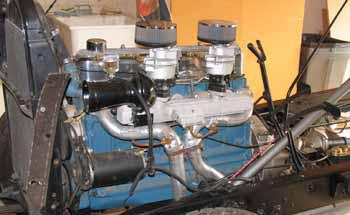

      Anyway here are some pictures to up date my old entry to the gallery. The truck is now sporting a '57 235 bored 60 over, M4F cam, Fenton exhaust, and Offy dual intake. The 3-speed transmission and drive line are original. I still need to tweak the dual Rochester a little but it runs very well.

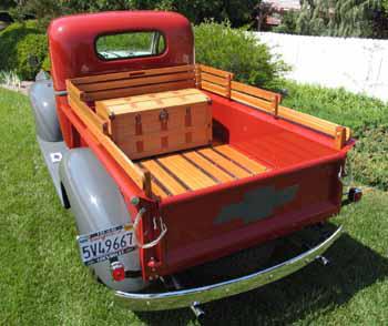

      I built the side rails and bed from Philippine mahogany because the color went with the color of the truck better than anything else. I also built a trunk out of oak. I had to have somewhere to keep some tools and things so the trunk seemed to be a good choice. The plans for the trunk came from Rockler (a woodworking catalog outfit -- you can order a catalog on-line ~~ Editor). The hardware is also from them. I put in about two months of Saturdays building it. It's not for the beginner but not all that hard to build. It's bolted down using two bolts through the bed strips. Milling the grooves for the bed strips is a snap if you have a table saw. I guess it could be done with a router also. It took a little care to get the bed mounting holes in the right place but the instructions that came from Mar-K were excellent.
      Woodworking is my real hobby; the truck is my mid-life crisis!
      Here are two pictures of my engine. (As requested by some of the Bolters ~~ Editor!)
      These were taken before I put the body on. Tay way you can easily see what I've done.
      I don't know if you noticed, but I put a third brake light in the cross rail just below the back window. My wife said I had to have a third light because the originals are pretty small and with all the traffic around here you really need it. The wiring runs in a grove in the bottom of the top rail and down through the corner post so nothing is showing. It worked out pretty neat, even if I do say so myself.
