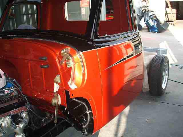

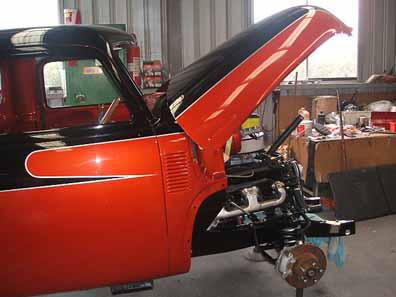

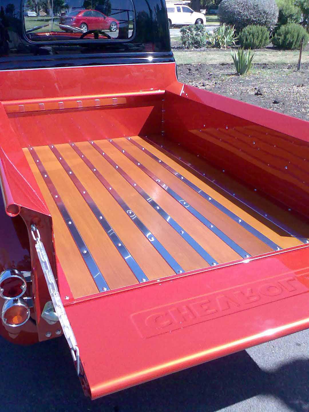

           Early picture during restoration --I lost most of the "as arrived" photos. Here's a photo of the back section. Basically the truck was complete. Considering it came from Canada, the cab was fairly rust free (salt). However the pickup bed was past redemption. A totally new bed was made re-using only the original front stake pockets. A very talented panel beater / painter by the name of Perry Bekkers was tasked with the initial pickup bed construction. After seeing the quality of work, it was only sensible to have him finish the job completely. As a shiftworker, I had many hours available to assist Perry with his work. This was a delight as I learned many new tricks with restorations, making patch panels and paint preparation. Here's an early photo of the front, with the hood on, still in primer.
           The filler panel under the grille is steel, made in the same shape as the repro grille. The front guards need to be modified slightly in the corners to make this panel work. The guards have a curve which generally is not seen with the gravel tray in place. But once this is removed, this does stand out. So the front guards were squared off following the line of the grille fold. Perry made the panel that can be seen, Unfortunately I had to work and did not see the panel's creation. He is one clever dude !!!!
           The suspension is TCI Mustang II with stainless upper and lower arms and a 8 3/4 Ford rear. Another firm used from the Internet was Allan Automotive from Calgary. They supplied all the other front end parts, needed springs, shocks, caliper brackets, etc. The power side is 327 small block and TH400 -- basically stock built for reliability as I intended to do many miles to events around home.

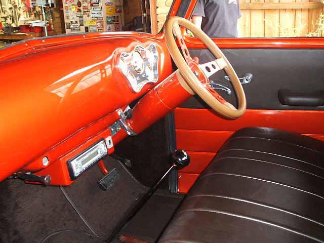

           The truck was wired by me (I'm an electrician) using a billet dash insert. The dash is metal finished right hand drive conversion. This conversion was more work and time than building the pickup bed. The trim is brown leather over the original seat with the headlining supplied by American Classic Truck Parts. (Interior pix) Timber boards have been changed to make equal bed widths. They've been stained and sealed. Both bumper bars have been removed. Perry made a metal filler panel for the front and a box section to cover the rear. The rear guards were lengthened at the bottom to meet up with new box section, giving the rear a smoother look.

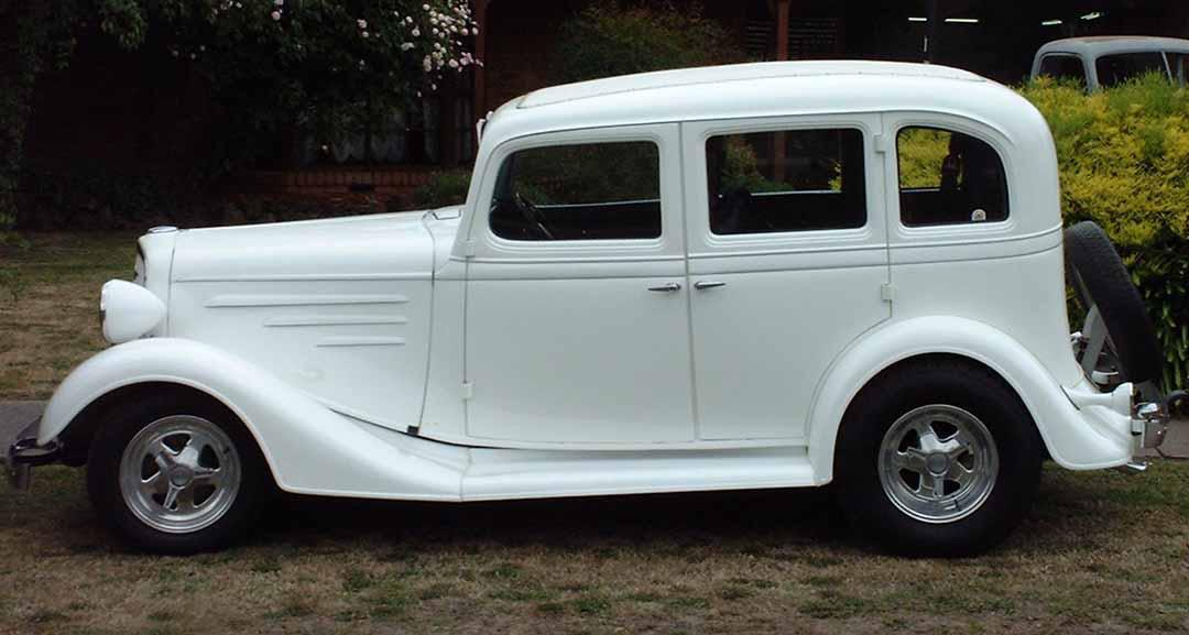

           I also want to mention my wife Anne and thank her for her support; and my two boys Rhys and Mitchell for their assistance. Without family support, this would never have been done. This is my second project. Here's a photo of my 1934 Chev standard or junior 4 door 283, TH350.
