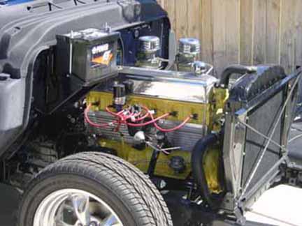

           I purchased this truck from my Uncle who had it in his back yard since I was in high school. In June of 2000, I stripped the truck down to the bare frame and started over. The frame was powder coated and got a TCI mustang II IFS. The rear end is out of a Camaro I found in the salvage yard. I also found a T5 tranny that bolted right up to my 235 inline six.
           I put an Offenhauser dual carb intake and ceramic coated Fenton headers on one side and a HEI distributor on the other. I took the wing windows out and put a one piece window kit in. The rest of the truck is mostly stock.

          I took the truck down to the bare frame and had it powder coated. The chassis has a TCI Mustang II front end, a power brake booster and a 10-bolt rearend from an 1989 Camaro. The fuel tank is out of the cab and under the bed. Here's a shot from the rear.
          I put an Offy dual intake and Fenton headers that are ceramic coated on the engine. An HEI distributor from Buffalo Enterprises provides the spark.
