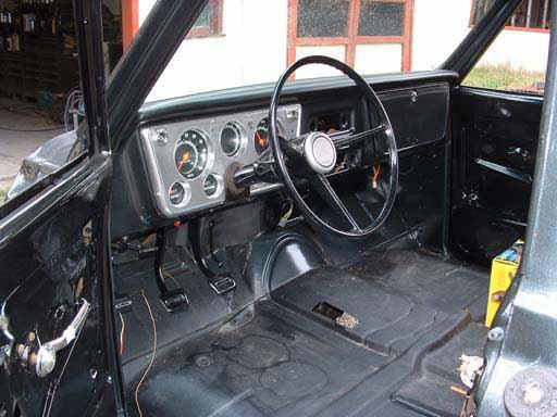

           I have a few shots for you (finally) of the three donor trucks. At this point, I have the short bed frame done and it really looks nice. I'm building the engine. Here's a shot of the interior.

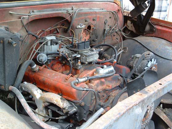

           I have included a shot of the "before" of the motor and one of how it looks now. It's a 1968 327 4 bolt. I had it bored to .030 over and line honed. I used a new Scat steel 350 crank and TRW forged pistons, so it will end up at 355 CI. I will be using 76 CC 2.02 S/R heads and an Edelbrock manifold and 600 CFM carb. The compression should end up around 8.7 to 1.
           I'm using the front clip and doors from the 1968. The cab is from the 1969, and the frame and bed from the 1970.

           My 1969 - "Homer" -- Another old daily driver. I ran this truck for years and just did what it took to keep it running. When he was retired, he smoked so badly that environmentalists would have cringed. He's been an organ donor for a while now, hence the missing headlights, master cylinder, and a bunch of other stuff. Here's Homer's dead 327 engine as she looked during his dissection. You can just get a glimpse of my brother's '69 parked beside it. He another member of the Ol' Chevy Truck Club.
