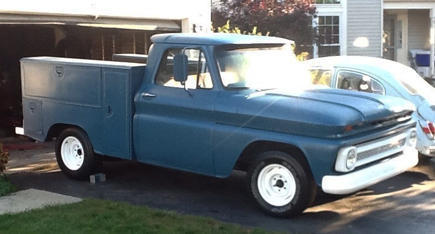

We were looking around for a truck that would work for our son who was 19 and attending a local welding school - working full time and going to school at night. We kinda looked at the 60's to 70's era trucks, thinking that would work for him. Well, we saw this '64 on eBay and looking thru those pictures on-line, it clicked. We knew that would be perfect for Stan, especially with that utility bed.
The truck was out in Montana. We talked to the owner on the phone several times. He was good enough to walk around the truck with the phone and explain to us some of the damaged areas, etc. He never had a car shipped before, so I walked him thru that process. We sent off a check and I made arrangements for the pickup with a carrier. It was quite fortunate that the day the previous owner received the check, the shipper was coming thru and able to pick up the load. I think the PO was surprised how quickly and painless it all was ... us, too!
When the truck arrived, we power washed it in order to get a better look at what needed to be done.
Well, one thing lead to another. We took bolts off here and there to "clean." Before we knew it, the truck was completely taken apart. Everything was off it.
So, we had it completely stripped down. We took the cab down to the bear metal. My son had his chance to practice welding all over the truck!
The truck came with a good 292 ci engine. We completely sealed and painted it. The transmission was 4 speed with granny low. We cleaned it up and painted it.
We didn't do much to the frame but strip it down and power wash it. We painted POR15 over the entire frame.
The interior of the truck was pretty good. There wasn't much to do with the dash. I got a new bezel because the old one was pretty beat up. The gauges were in good shape; all we needed to do was clean them up.
We did all the body work and painting in the shop. A lot of the body work was with the floor and rocker panels.

That was it for the cab metal that was replaced. Of course, both utility boxes bottoms were rotted out so we pulled them apart. We got them clean, down to bare metal. We cut out and replaced the damaged parts with 16 gauge steel plate. Then got it primed and painted.
The wrinkly steel sheet of the bed was replaced with new 16 gauge plate.
We made the rear bumper out of light gauge metal framing members.
We never really planned on taking the whole thing apart. It just sorta "happened" as we started to get to the body panels that were bad.
"It's only a few more bolts then we can get to such and such, and clean and paint it," -- we said that a lot!
Back in August of 2012, we cleaned it up a bit and took it to a local show. After that Montana started her new life as my son's daily driver. It's a great vehicle.
