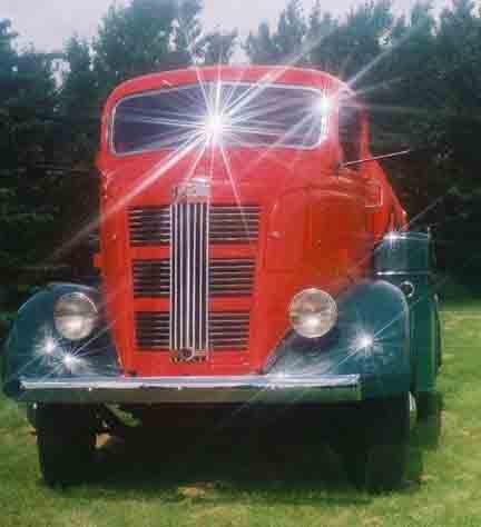

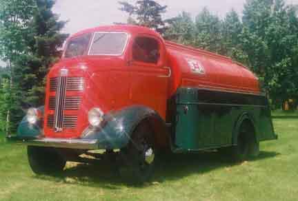

This is Lou Shirvell's 1937 GMC F33B COE. He has owned this truck for nearly 20 years. It was nine years to complete the restoration. It has always been stored inside and insured.
