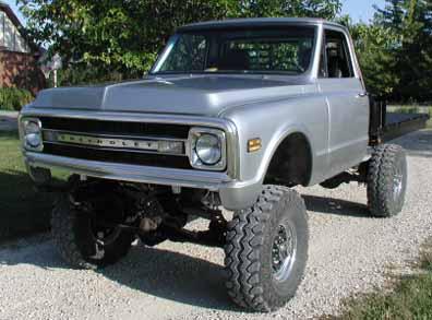

             Here is some updated info on my 1969 K20. Since my last update, I have come a long way. I got the body all sanded and made the decision that I was not up to the task of painting the truck myself. Off to the body shop the truck went and then many months later, it came home ready for final assembly.
             I have refered to the truck as both a C-20 and K-20. The four wheel drivers are K series trucks but GM kept the C badges. Only the Blazer has the K badging, even the two wheel drive Blazers have the K badging. Good old GM being cheap on badging if you ask me.
             The truck is running a 1989 454 and I swapped over the donor vehicle's hydraulic clutch and hydro boost brake system.
             My lift has now increased and the truck could use some larger tires at this point.

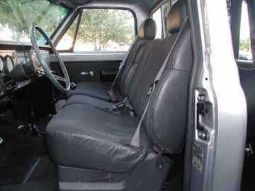

             I am using seats from a 1998 Chevy Silverado and I also bought some of the bulk seat fabric and used it to cover the door panels.
             I have a tilt column that is ready to be installed once I get some free time.

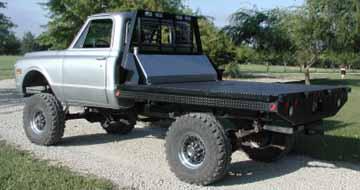

             I had the gas tank on the flatbed custom built to follow the lines of the flatbed's headache rack.
