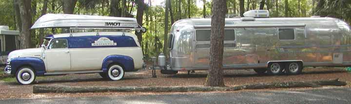

       I acquired the very red '47 1-ton Panel truck in 2000 in very good shape. I was told I am the third owner. It came to Florida from Pennsylvania by its second owner. The first owner was a farmer in PA. The second owner used it to haul a motorcycle and carry band equipment.
       The truck still has original oak floor boards attached to the original frame. I had a vision to make it look as much as original on the outside but modern on the mechanical and drivetrain side.
       It now tows a 1976 Airstream for family camping trips and some wooden boats to boat shows.
