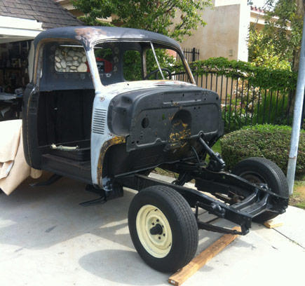

Above shows how far we have gotten so far.
This is how it looked when we brought it home!

The '49 was rough but had great potential. It was mostly all there in parts and had minimal rust. So I bought it!
According to the VIN number, the truck was made at the GM Oakland Plant, a production date of June 1949 and number 6,705 to come off the assembly line.
Now begins the process that separates the men from the boys: restoration.
I was lucky to have a friend who lives close by who never met a bolt he couldn’t grind off or heat off or bang off, because these bolts on a truck 65 years old did not want to budge.
We did it though. Over time, the fenders came off, and the bed came off. I cleaned out and de-rusted and primed the cab. We strengthened floor areas that needed it and I used POR 15 on the frame.
It took some time, but I finally got the paint off the rear fenders. The front fenders were next, followed by the hood. Then we worked on the doors and then the bed sides.
I am going to be putting on a modern front end and am doing the research into that now.
When I bought the truck, I told myself this was going to be a three year project. I’m one and a half years into it now and am making great progress. It is a labor of love for me as I am learning a great deal as to how something was constructed way back when. I am also doing something more important than that -- I am bringing back a piece of automobile history for everyone to enjoy. My wife included -- I hope.
