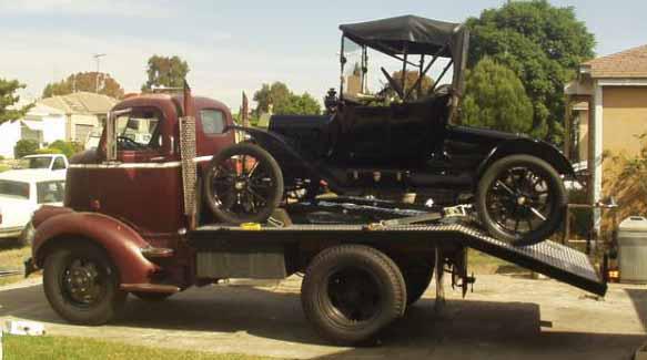

           I got my truck about four years ago. I like old motorcycles and I wanted a model T. My friends said you would have to get a car trailer for the T. Well, I am hard-pressed for room and I don't have any room for a car trailer. So I thought I would try to get a truck that could do both -- haul a Model T or my old motorcycles.
           That's how I ended up getting the 1947 Chevy. It has a 109 inch wheel base and had a fifth wheel. My brother and I built the bed just for my purposes. Here is my Dad, brother and me when we were building the bed. It was the first welding I had ever done. It took us a week of work and I have made some more braces since these photos were taken, but that's basically the shape of it.

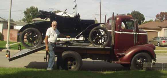

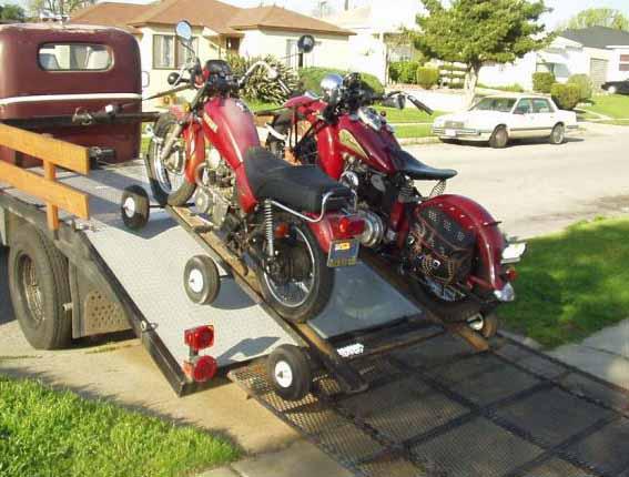

           It works great and I have hauled both the T and old bikes to meets and runs with good luck. Here's another view with the Model T loaded. This photo shows how I load the bikes. The Yamahas are my Dad's. He is a real Yamaha man. When we are riding the bikes, the cab over is the rescue vehicle.
