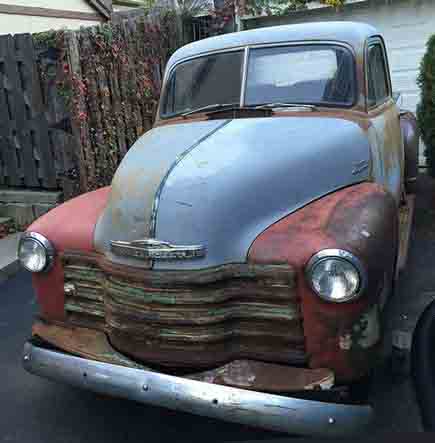

I picked up a 1951 Chevy 3100 1/2-ton in late August in various forms of disassembly and I aim to get her back on the road by Thanksgiving!

At this writing, I've completed the following:
  • Installed the motor
  • Installed the radiator
  • Installed the transmission
  • Pulled and cleaned the gas-tank
  • Assembled the various bolt-on body panels
  • Started the motor and tuned it to idle (first time since the mid-80's!)
  • Began painting the motor
Items remaining before initial road test:
  • Finish painting motor
  • Replacement of motor gaskets
  • Replacement of motor mounts
  • Reinstall gas tank and sending unit
  • Go thru brake system
The next week was a busy one! I got a lot of work done on the pickup and things are really starting to take shape!
I have worked to paint the block, valve cover, push-rod cover as well as replace the fuel pump and all relative gaskets for these items. I have also painted the starter and the generator. I'll be painting the other bolt on items (oil pan, water pump, harmonic balancer, distributor, oil filter and air cleaner while breather tube will be getting replaced) and replacing their gaskets in the coming days.
