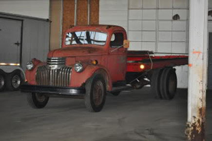

1946 2-Ton Chevy
From Randy :
I purchased this old truck from Larry Sparks (a country / bluegrass legend) back in 2010. I never realized how much work these old truck needed. I started out making a new wiring harness. I put a modern alternator, fuse block that uses ceramic fuses, cloth covered loom for the wire, 1157 bulb sockets for the front parking lights to use turn signals from the same light -- just to mention a few of the upgrades.

We took care of that in a few days, and she was driving great. It made its first deliveries in April 2013, in who knows how many years. I made new mirror brackets ( they were quite the hit in the Big Bolts forum ~ Editor )

I bought a cheap flatbed that needs some help. It will work for now until I can build a more period correct one to use. The bed that is currently installed is built from tongue and grove 2 X 6s and it is impossible to tie anything down to it.
