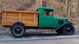

Finally (Sept. 2001) got the 2 inch thick rough cut red oak bed on for hauling
coal. The extra weight on the truck helps with the "Ruthless" ride now. The
red oak was green and I applied liberal amounts of linseed oil to it.
    I gained 560 pounds with the new bed and gross weighted at
4,000 lbs even. Drying over the winter lightened me down to 3680 lbs as per
my last (Mar 02) coal run. I have had 2250 lbs of soft coal on grossing at 6250
with the new bed.
    When I enter the coal yard in Snowshoe, PA on Saturday mornings, every trucker stops and jumps out to stand around and watch as the '31 gets loaded. The looks of disbelief are priceless.
    Steering good, brakes a little touchy. Heres new pics of the bed. Next is the dump mechanism. Not sure if I have pics with the coal on.
