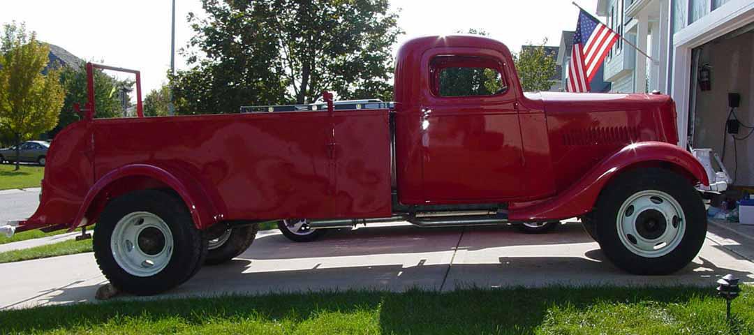

           Well, I guess it is time for an update. I did not realized it’s been over five years since my fist post on the Stovebolt Page. I now have been re-energized by my two helpers to get the old truck going again -- one is 5 and the other is 1 ½ years old.
           All along I have wanted to keep the truck as original as possible but after the first drive down the block and the brake pedal went straight to the floor. I figured it was time for some changes. I searched for a donor truck that had all the pieces that I needed to finish the job. I found the necessary parts from a '92 Chevy P-30 chassis.
           The 4-wheel disc brakes worked so well I decided, "Now that it stops so well, I need more power to make it go." I converted the old truck to a 350 with an automatic transmission and that seemed to fix all my power issues.
           OOOOPs!
           Now it steers like a bus. So next was the conversion of a tilt column, “cross steering, and a power steering box. WHEW!!!! That was a handful.
           Now all that’s left to make it road worthy is to put the windows and interior back in.
